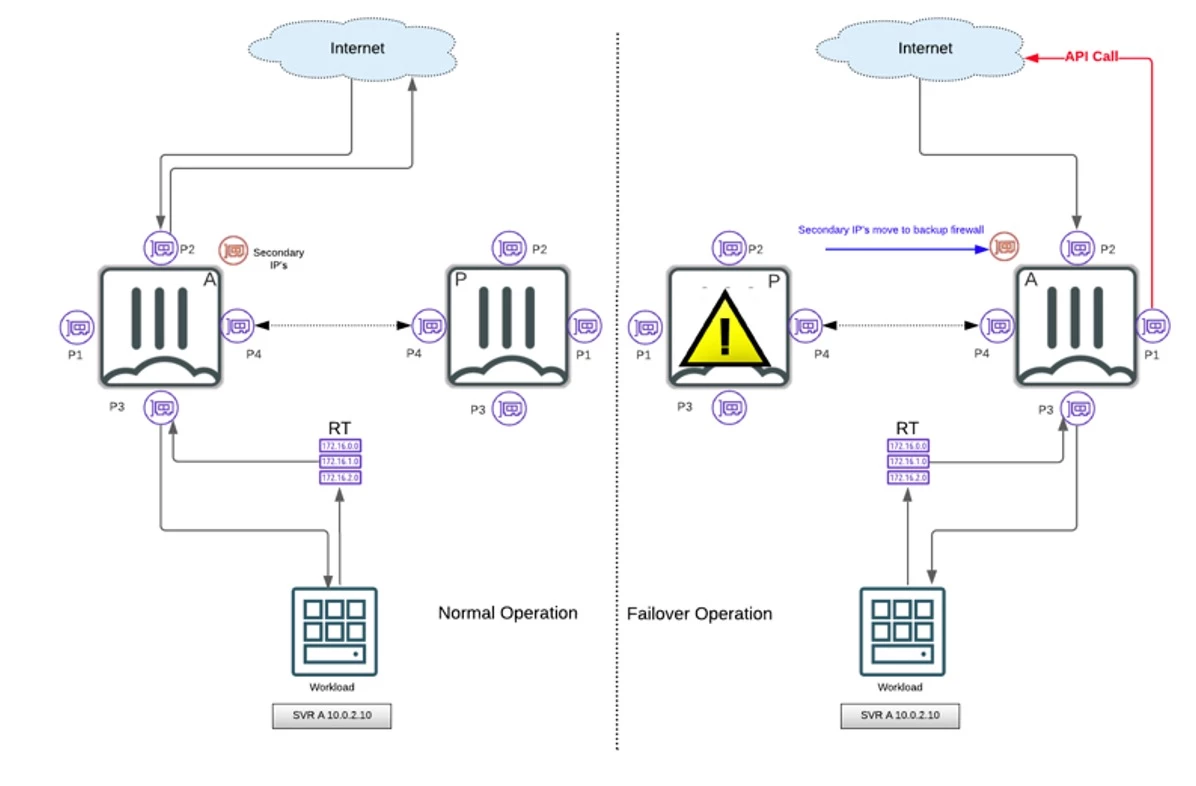

As per the architecture explanation, the traffic from the ON-Premise Data center routes to the Fortinet FortiGate VM in through the untrust subnet. However, in the diagram (North-south inbound traffic) if we look at the Hub VCN Ingress route table, the traffic coming from on premise is routed to Secondary IP of Port 3 which is a trust subnet. Can someone clarify here ?
https://docs.oracle.com/en/solutions/secure-oci-workloads-fortigate/index.html#GUID-40CF25A9-E13A-4C92-8E21-D395920BB46A

It seems that this is because the architecture in place in the diagram consists of an A-P cluster, which is why the RT points to a secondary IP. I hope that clarifies things.
Kind regards,
Stephen_G - Fortinet Community Team
sbaugh_FTNT
February 13, 2024
Hi,
Secondary IP's are used for the failover mechanism and are moved between A-P members, so the RT needs to point to the secondary IP.
  1. Failure of the active firewall is detected by the passive firewall.
  2. The passive firewall makes an API call from the management interface.
  3. Changes to OCI are made:
    1. Secondary IP’s is moved from firewall one untrust interface to firewall two untrust interface.
    2. Secondary IP’s is moved from firewall one trust interface to firewall two trust interface.
