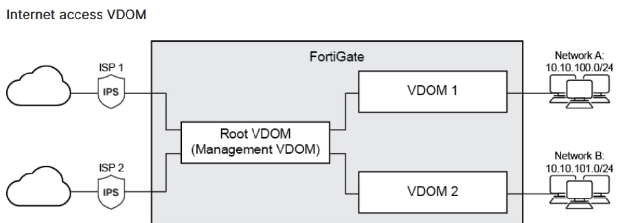

hi,
i plan to configure SNAT in a FG with multiple VDOMs.
i currently have the "internet VDOM" topology wherein "internet" VDOM act as our internet edge device and all downstream VDOMs will connect/flow through it to go to the public internet.
my question, if i create a FW policy WITH SNAT in "VDOM-1", do i also create FW policy WITHOUT NAT in "internet VDOM" for traffic flow continuity?
Best answer by Toshi_Esumi
Yes. If that VDOM customer/users need to use just one NAT outside/public IP, that's all you need. However, you have to assign at least /31 public subnet to the npu-vlink interface and each side (root and customer vdom side) takes one IP out of the /31.
Toshi

Hi,
Usually, in VDOM1/2 where the internet links are not directly connected, you would not need to activate NAT.
Assuming you have the correct routes back to VDOM1/2 in the Internet VDOM to the networks, you would only need to activate NAT in that VDOM where the traffic exists to reach the internet, Internet VDOM.

hi,
so i just need to provision FW policy with NAT in the "internet" VDOM only?
then just routing and FW policy in "VDOM-1"?
would i need 2 FW policy, i.e. first FW policy is the vlink (to internet VDOM) to "inside" interface of VDOM-1, second FW policy is the reverse, i.e. "inside" interface of VDOM-1 to vlink?
funkylicious
November 11, 2024
You would need a firewall policy in VDOM1, from LAN to vdom-link, allowing the traffic, no NAT.
In INT ( Internet ) VDOM, a firewall policy from vdom-link towards the WAN interface with NAT active.
Since FortiGate it's a stateful firewall, you would not need firewall rules in reverse created.
TLDR;
VDOM1: LAN > vdom-link ( accept, no NAT )
INTERNET: vdom-link > WAN ( accept , NAT )

hi,
thanks for your answers! appreciate them.
another question, can i do NAT in "VDOM-1" since it has a private (inside) interface/IP and public (outside) vlink interface/IP?
the "internet" VDOM has vlinks (using public IP) in downstream VDOMs (i.e. VDOM-1, VDOM-2, etc), outside interface using public IP and configured with iBGP with our internet edge router?
what will be the FW policy and NAT would look like in this scenario?
