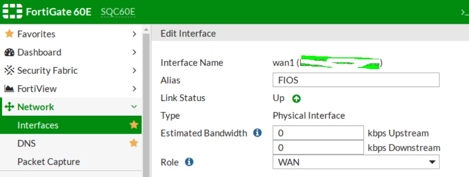

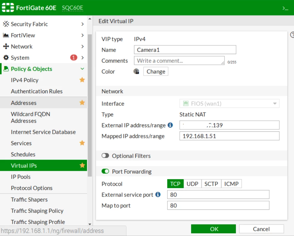

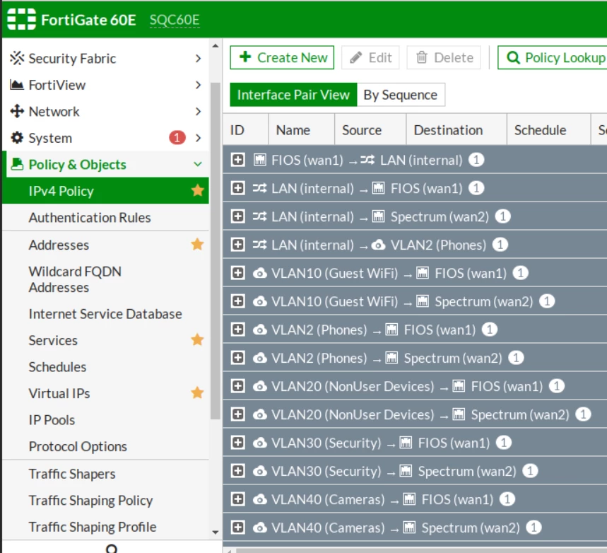

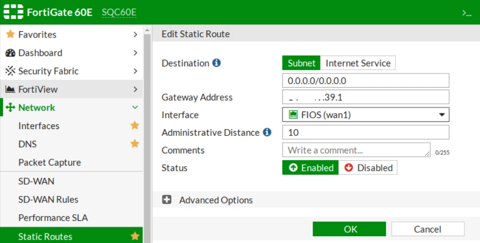

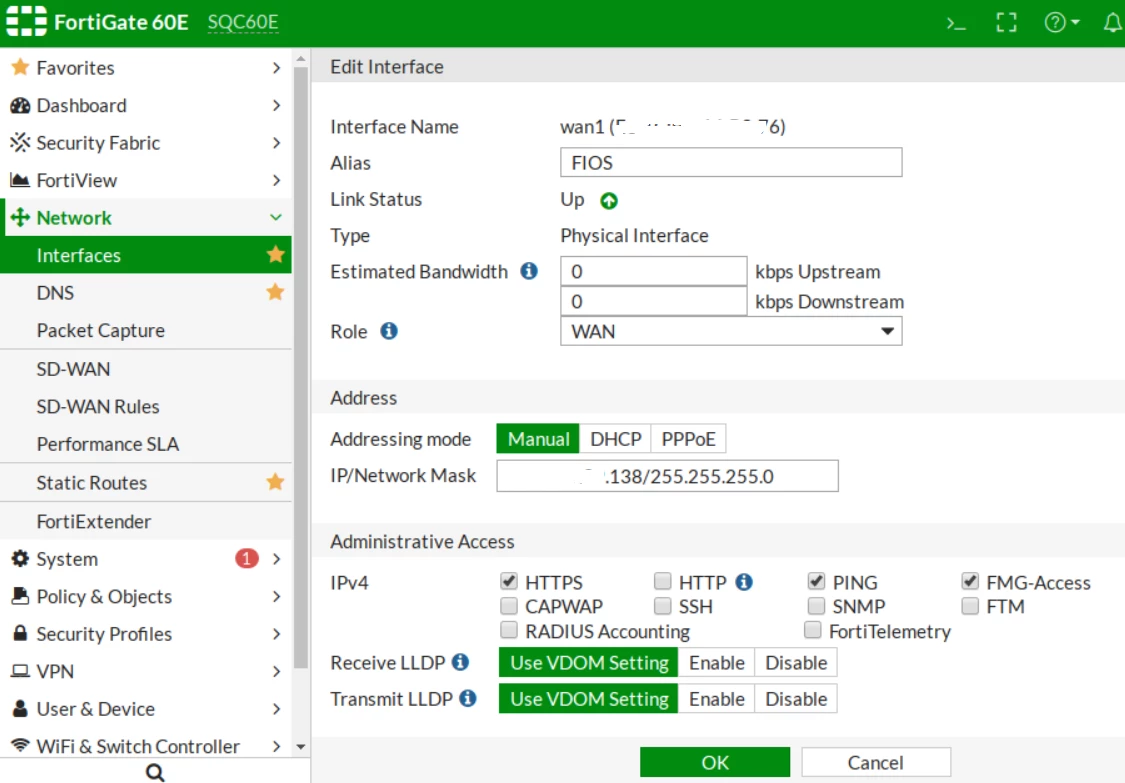

Thanks, for the tips! I am a little nervous about breaking the whole system as I am not sure what all the settings mean. In any case, here is what I plan to do and you can correct me if anything is wrong:
First thing is we won't be needing the backup Spectrum Cable ISP anymore. So per your advice we are probably safe to ignore it or unplug it.
Here are settings for the new Spectrum FIOS internet:
IP Address Network xxx.xx.xx.144/29
Gateway xxx.xx.xx.145/29
Usable: xxx.xx.xx.146 Through xxx.xx.xx.150
So first I'll unplug the Verizon FIOS and then plug in the Spectrum FIOS to the same port. Next I will overwrite the current settings for Verizon FIOS with the the new values wherever applicable in the screenshots below:
The last image is for a raspberry pi running a web server off port 80.
distillednetwork
Explorer II
October 24, 2022
Yes, that looks about right.  The only other thing which I assume would not be the case would be anything under SWAN.  Looks pretty basic and those changes should do it based on the information provided in the screenshots.

One thing I am not sure about is when I click the settings for the current Verizon FIOS it shows some kind of MAC ID for the WAN1. Will this dynamically get updated when I plug in the Spectrum FIOS?
AntonyChen
Explorer II
October 25, 2022
mac address not changed when you replace the isp, it's binded to device interface, you said that you can connect with your laptop, it means your ISP not require correct MAC authentication, so you dont have to care about the mac address this case, also mac address of interface can changed in CLI mode, but you dont need this .
some ISP require pppoe authentication while other provide static IP without pppoe dial. And i think that your isp provide static IP
distillednetwork
Explorer II
October 24, 2022
That should be the mac address of the wan1 ports itself not the mac address of the modem.
