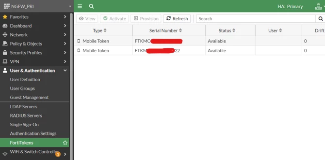

To Add newly bought Tokens to FortiGate: -
  1. In User > FortiToken > Create New > enter the serial number of the FortiToken and click on ‘+’ symbol, and click OK.
  1. By default, we get Two FortiTokens available with the FortiGate in place.

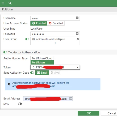

  1. Enable FortiToken on user: -
Enable the Two factor authentication, and select the FortiToken serial number which has already been created.

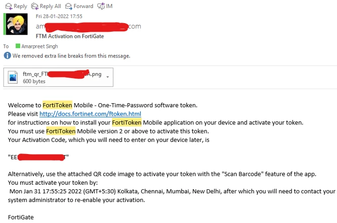

Select Email and provide Email Address for one time FortiToken Application setup
Scanning the QR Code via Mobile App (FortiToken Application) Downloaded

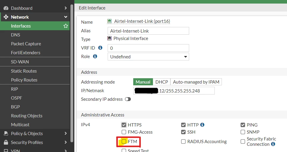

Edit WAN interface from where SSL VPN setup is done. Enable FTM for FortiToken Mobile Authentication.

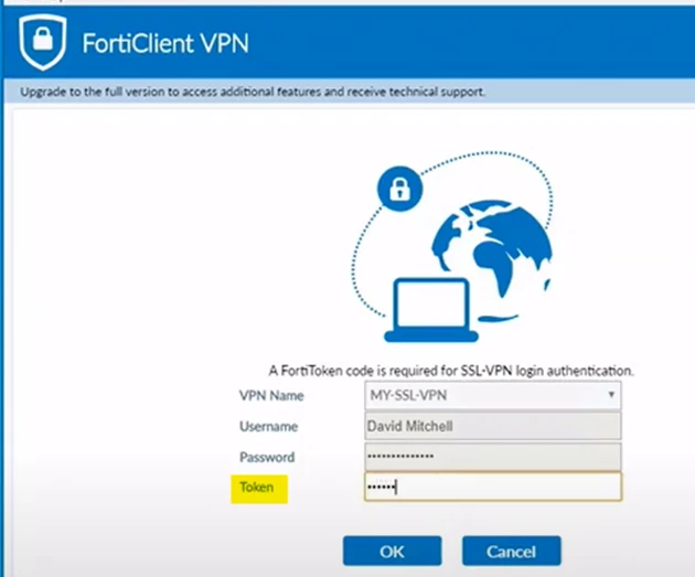

Testing
Open FortiClient and Select VPN Profile along with username and password followed with OTP.
