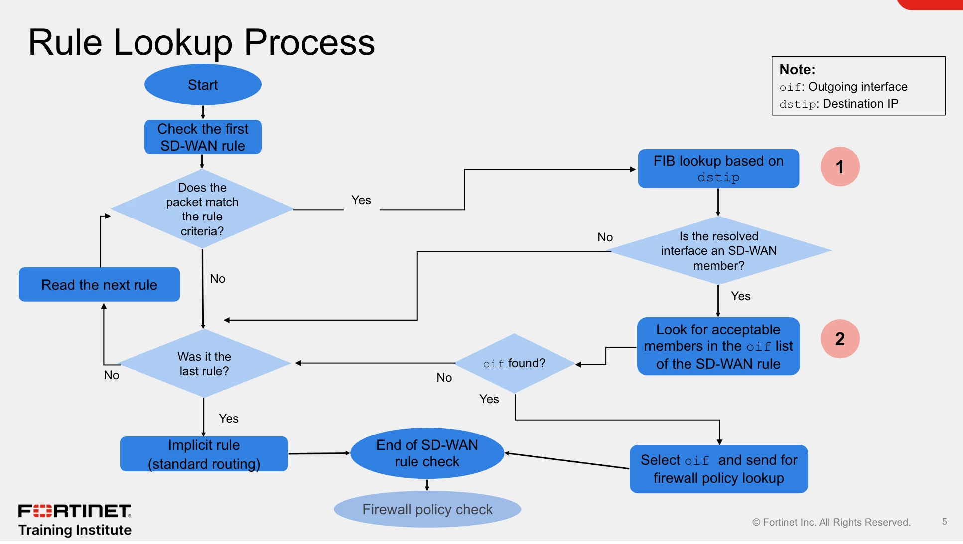

Hello.
Below is my understanding of the conditions for SD-WAN rule processing. Is this correct?
  1. The interface must be configured as an SD-WAN member.
  2. An SD-WAN policy must exist, and the traffic must match that policy’s conditions.
  3. The FIB is used to determine the next hop. FIB entries come from the RIB , which updates the FIB automatically. To add information to the FIB, routes must first be added to the RIB.

Hello
Here is the rule lookup process from the Fortinet Institute:

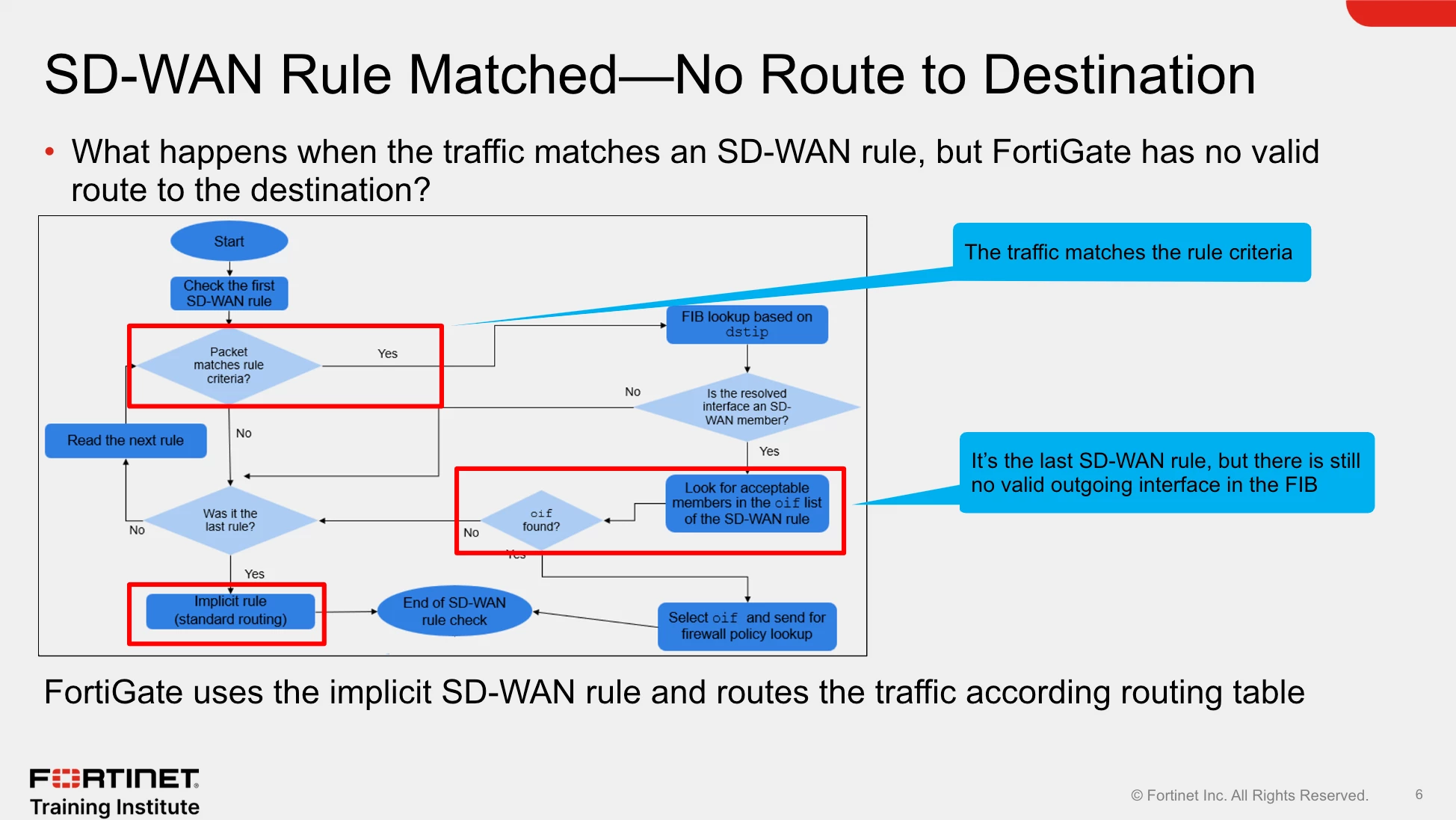

Feb 17, 2025 6:47 PM UTC
And also:
I guess that you should find all what you want on the FCSS SDW free lesson on the Fortinet Institute.
