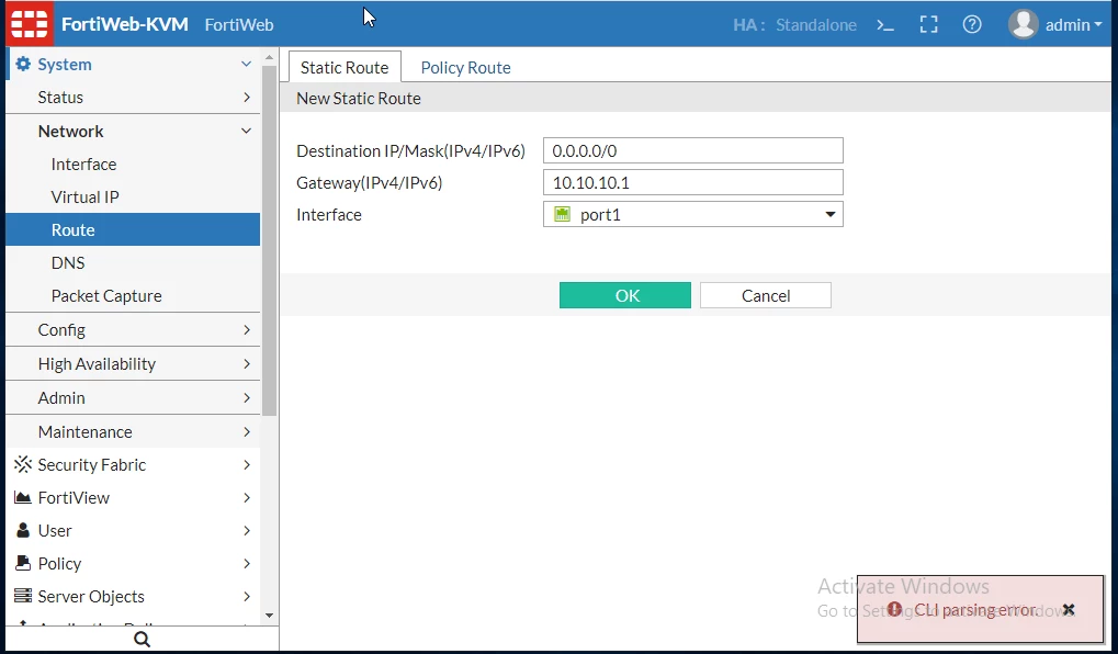

Hi guys,
Maybe someone had this before. I am using an trial/evaluation version of FortiWeb 6. According to Fortinet I should be able to evaluate Fortiweb for 15 days. Now I am trying to create the first Static default route towards my Fortigate. When I click on a OK nothing happens. When I click on OK again I get "CLI Parser error". And here is where it gets stuck. Via CLI it will kick you out and you would have to logon again. Afterwards only parser error when you try again. I tried v6 built1464 and 1489. Anyone experienced this?Fortiwebv6built 1489.PNG

    Hello,
    When entering a command, the CLI requires that you use valid syntax and conform to expected input constraints. It will reject invalid commands.
    For example, if you do not type the entire object that will receive the action of a command operator such as config, the CLI will return an error message such as:
    Command fail. CLI parsing error

    Hello @Chuchubi ,
    Thank you for contacting the Fortinet forum portal,
    -As confirmed by my @Raghu_Kumar  because of the error in the configuration you might see that error.
    -Did you try creating from CLI ? if not I would recommend to try
    config router static
    edit <route_index>
    set device "<interface_name>"
    set dst "<destination_ip>"
    set gateway "<router_ip>"
    example: default gateway
    set dst "0.0.0.0 0.0.0.0"
    set gateway "192.0.2.1"
    set device port1
    -In the above diagram which you posted you didn't enter full destination 0.0.0.0/0.0.0.0 please correct and check.

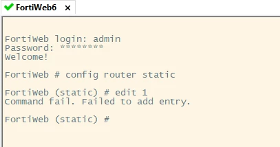

    Chuchubi
    ChuchubiAuthor
    October 1, 2023
    Hi Manasa,
    When I run the command in CLI it won't even take the "edit 1" string. Let alone the rest. As I mentioned above this error I get it in GUI and CLI.Fortiweb failed CLI command.PNG

    @Chuchubi Could you please share the output of the following commands?
    show system interface port1
    show router static
    Chuchubi
    ChuchubiAuthor
    October 3, 2023
    @ddsouza_FTNT , I tested a few other builds and I found built 0577 that worked for me without errors. So I am just testing a POC with that version now. Thanks for your assist.
