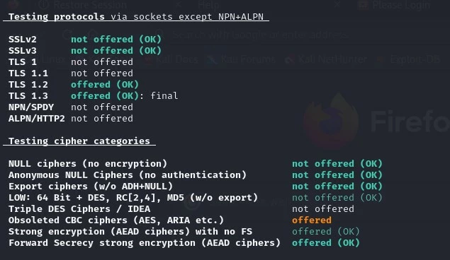

Dears,
I got this report from security assesment department,
Obsoleted CBC ciphers (AES, ARIA etc.) offered
The VPN fortinet hardware 1500d
Could you please help me?

You can get rid of some obsolete algorithms in CLI like this:
config vpn ssl settings     set banned-cipher "AES" "3DES" "CAMELLIA" "SHA1" "STATIC" end
