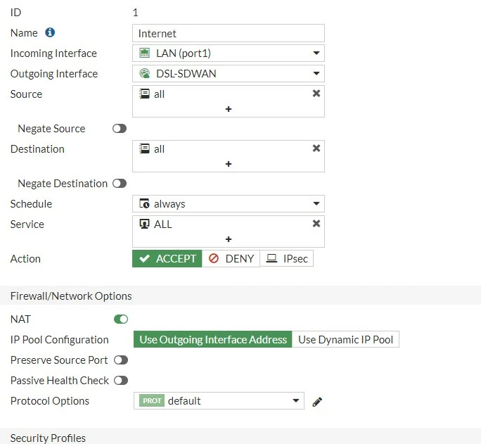

I have deployed Fortigate-VM and I am able to access the GUI.
The firewall can access the internet but as a users I can reach the firewall but no internet connection.
I would like some help if there is any configuration needed on the ESXI or the switch where its connected.
1 port connected for LAN and another port connected for WAN.

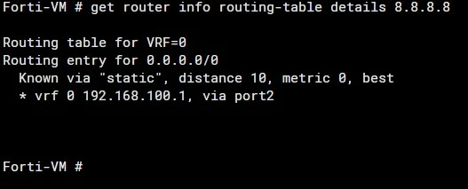

Can you share "get router info routing-table details 8.8.8.8", and check the forward traffic logs under "logs and report" to see if there are any logs related to your source IP?

for simplicity i removed sd-wan and only created 1 wan port and made changes to the routing and policy for that WAN only

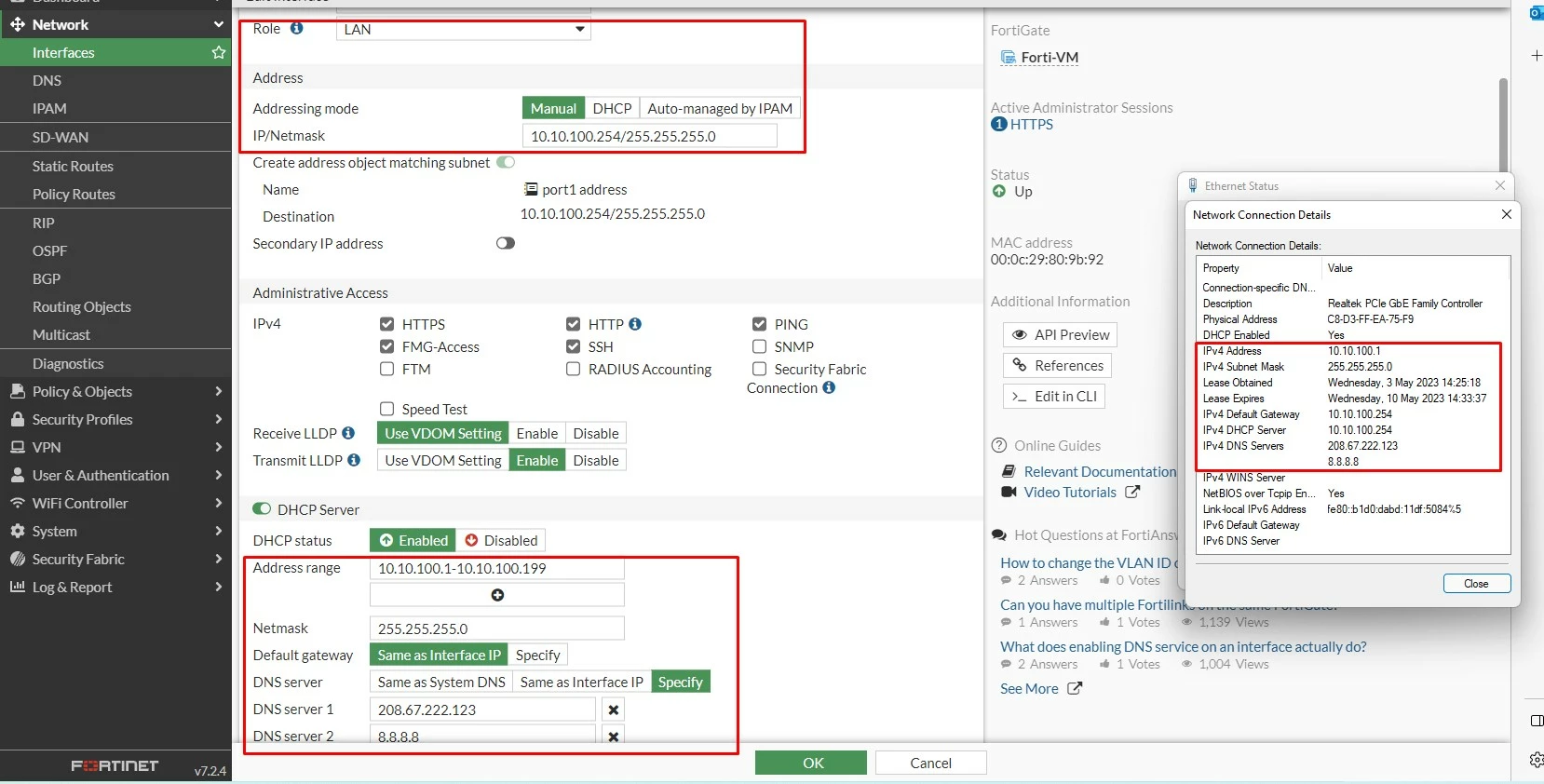

From the user machine, are you able to ping the fortigate IP -10.10.100.254 ?
afarouk
afaroukAuthor
May 3, 2023

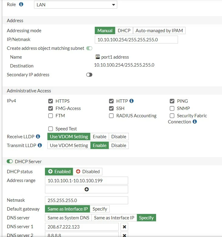

Did you set up the LAN subnet as a VLAN?
On the second screenshot, I see LAN having VLAN ID of 100, but on fortigate you don't have the vlan configured on the LAN interface.

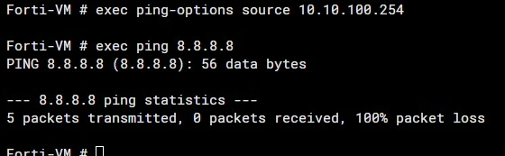

Can you also run these commands on fortigate:
exec ping-options source 10.10.100.254
exec ping 8.8.8.8

WAN ports has VLAN ID as well, its for the VM to tag it on the switch to communicate with the modem which has the same VLAN ID
am not getting reply with the interface as a source
