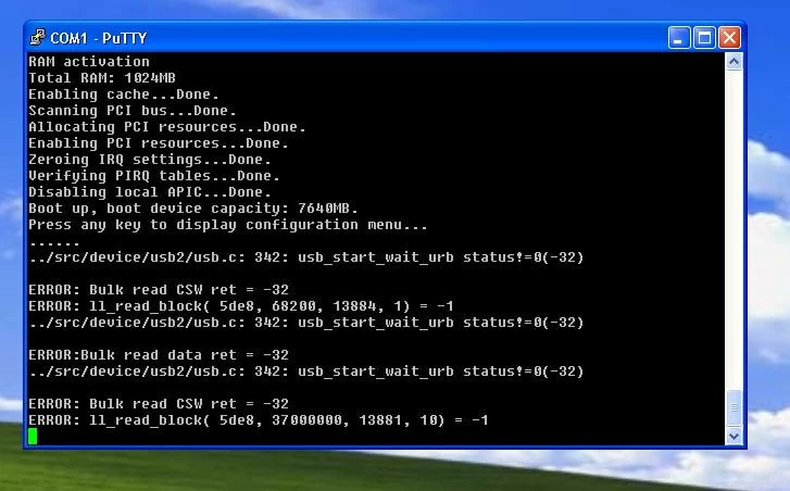

Dear all
I have a Fortigate 80C running version 5.2 but in one day after power off and turn on the system can not boot, and appear errors in the attachments. I tried many ways but ca not solve the problem. When i type the answer character the system will hang, i can not do anything. Please help me.
Thanks so much !!!

    Looks like a USB error. Try removing any USB device and restarting the unit.
    sw2090
    October 30, 2018
    if you have USB devices connected - rwpatterson might be right. In this case you could try what he suggested.
    Also it could have happened that something has corrupted your boot device in some way. This could happen if you just power off your unit without doing shutdown before.
    In this case you would have to enter the boot menue and format your boot partition and afterwards use tftp to upload the firmware again. However in this case all data - including your config - is lost!
