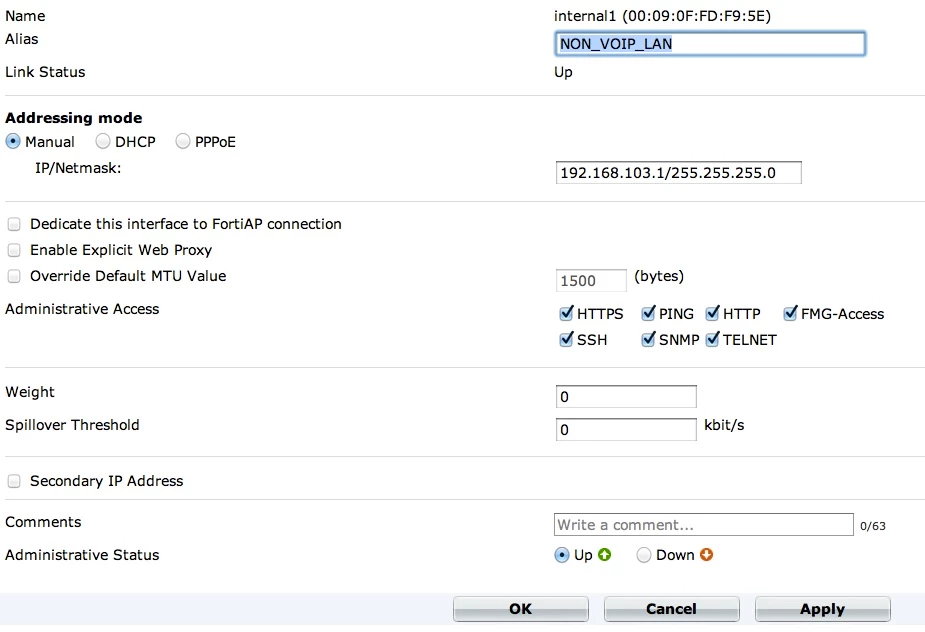

I have the 60c all setup and everything almost works as I want it to. 1st issue - I created a rule to be able to access LAN2 from LAN 1, both being on different subnets with the LAN ports operating in -- mode. I use LAN 1 for all traffic except my VoIP LAN, LAN2. The rule is simple and didn' t require a route policy. It worked fine until I upgraded form 4.0 MR2 to MR3 patch 4 The rule is as follows: Source Interface /Zone: Internal 1 Source Address: 192.168.103 range (Created an address 192.168.103.0/24) Destination Interface /Zone: Internal 2 Destination address:192.168.106 Range (Created an address 192.168.106.0/24) Schedule: always Service: Any Enable Nat: no It worked before the upgrade - now I can only access the Interface address of 192.168.106.1. Logs show " started" under status when I try to access anything else other than the port itself. All I want to do is be able to use HTTP to access the VoIP Lan/phones etc... Makes no difference where I put the rule, it still doesn' t work. I tried adding a Policy Route, but that didn' t change anything. I know this should be an easy fix...but I' m stumped. I also have a few VPN tunnels at the top of the list, and they work perfectly On another note - I' m on a MAC in a Windows Domain...and since moving away from my Sonicwall' s...the network browsing is ungodly slow on the MAC' s. Spoke to T/S and they tried and tried but were not able to resolve that issue.

    Hi, and welcome to the forums. You' re right, this should be simple. Unfortunately, you' ve left out relevant parts of the config which I kindly ask you to provide: - the interface config for int1 and int2

    Steve_Wertheimer
    January 30, 2012
    Thank you for your response - Here' s the Router Table running and the interface config...as well as the configuration of Internal 1 Internal 2 is the same - only on the 2nd internal subnet... Connected S* 0.0.0.0/0 [5/0] via 206.248.154.104, ppp1 [5/0] via 69.165.xxx.xx, wan2 C 69.165.xxx.xx/28 is directly connected, wan2 C 69.196.xxx.xxx/32 is directly connected, ppp1 C 192.168.103.0/24 is directly connected, internal1 C 192.168.106.0/24 is directly connected, internal2 C 206.248.xxx.xxx/32 is directly connected, ppp1
