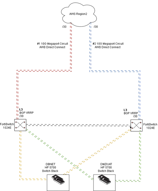

Can we do VRRP/BGP and redundant wan paths? Can it be active/active or only active/passive?
  • September 16, 2024
  • 3 replies
  • 1666 views
We have existing Fortiswitch that is connected to a Cisco ASR. The Cisco has the layer 3 interfaces and IP's assigned for WAN and vlan subnets. We want to now install a second FortiSwitch, use the layer3 capabilities and use vrrp to make the link redundant (will convert existing Fortiswitch after configuration for new Fortiswitch is working). We have installed a 2nd circuit and will configure it to this second Fortiswitch that will now handle layer 3.
In essence, we want the Fortiswitches to be redundant on the LAN side to handle Vlan's (is that MCLAG?) but also be redundant  but have a unique path out layer 3 to AWS. Each Fortiswitch has a separate layer 3 Circuit to AWS and I want to know if this can be Active/Active to use both circuits or only active/passive. The internet side is 10G for both circuits.
Please let me know if this makes sense. Can anyone share a similar config?

Thanks for the response. I have an issue at the moment that won't even let me get to the vrrp portion. I am unable to establish the layer 3 BGP connectivity on the FortiSwitch back to AWS. I had this same issue with the 1st FS and ended up installing a Cisco ASR in front to route layer 3 and get the BGP to work. How do i create an interface that can actually pass traffic at layer 3 on the FS? What am I missing?
config switch physical-port
edit "port28"
set description "Uplink to Megaport AWS-DC Circuit #2"
set lldp-profile "default-auto-isl"
set speed 10000full
edit "port28"
set native-vlan 364
set snmp-index 28
config router static
set dst 0.0.0.0 0.0.0.0
set gateway 169.254.96.33
config router bgp
set as 64516
set router-id 169.254.96.38
config neighbor
edit "169.254.96.33"
set remote-as 64513
