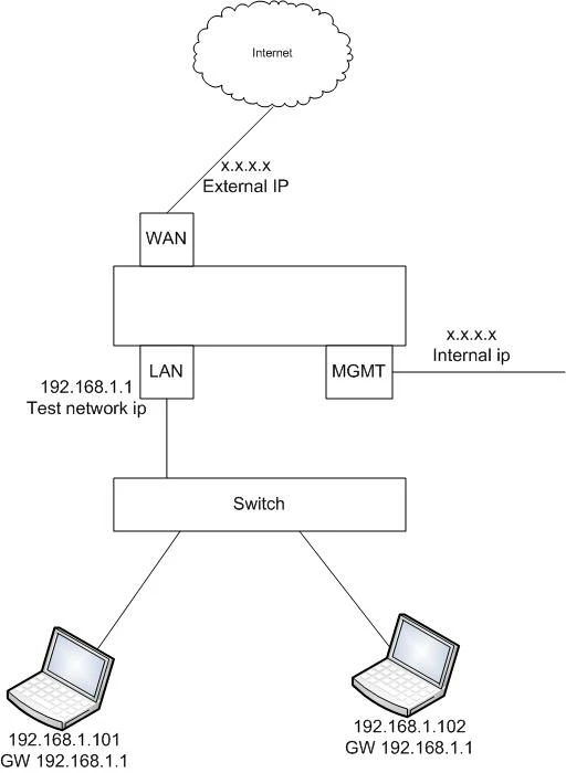

    Contributor
    January 21, 2010
    I drew up a diagram of what I' m trying to explain. I' m managing this network through a different port. The laptops can ping each other and the firewall can ping the laptops but the laptops can' t ping their gateway (the firewall).
    g3rman
    January 21, 2010
    Check out this blog post: http://firewallguru.blogspot.com/2009/02/securing-firewall-administrator-access.html If you set your admin accounts for trusted hosts that don' t include the 192.168.1 network you will not even be able to ping the firewall, regardless of routing.
    Contributor
    January 21, 2010
    I am too embarrased to talk, I honesty thought you were crazy, yet you fixed my issue, thank you so much.
