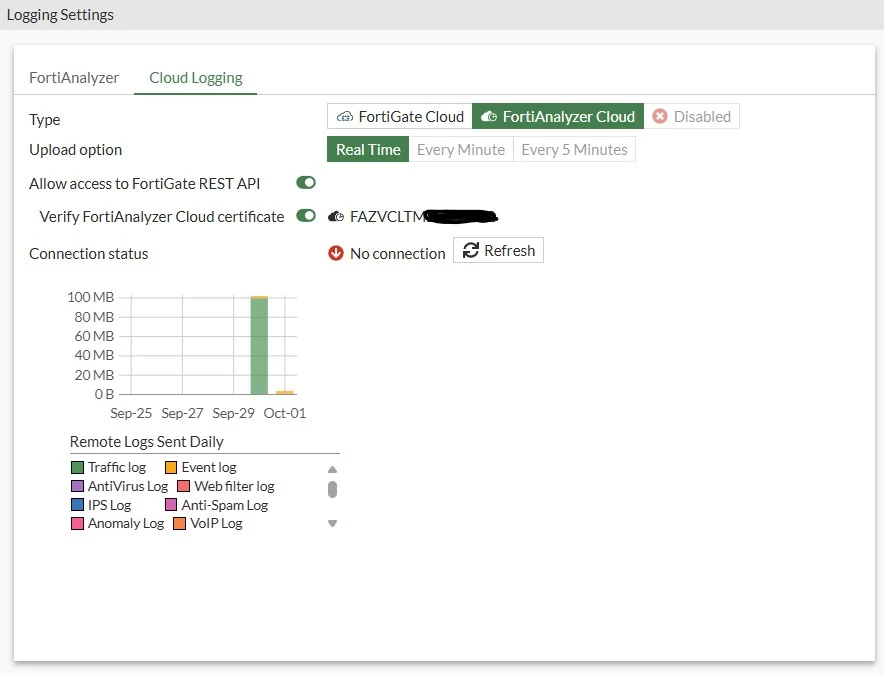

We have just upgraded our 100F from 7.0.17 to 7.4.9 with 7.0 going end of support.
It upgraded to 7.2 and then to 7.4
Everything seems to work fine with the exception of FortiAnalyzer Cloud. It's refusing to connect and send logs. We did upgrade the FAZ from 7.4 to 7.6.4 however it hasn't seemed to make any difference and both versions seem to support our Fortigate version. I have also removed the device and re-added it to FA Cloud still with no luck.
There's no access issues that I know of
# exec ping fortianalyzer.forticloud.com
PING fortianalyzer.forticloud.com.geo.fortinet.net (154.52.2.161): 56 data bytes
64 bytes from 154.52.2.161: icmp_seq=0 ttl=52 time=20.6 ms
64 bytes from 154.52.2.161: icmp_seq=1 ttl=52 time=20.5 ms
64 bytes from 154.52.2.161: icmp_seq=2 ttl=52 time=20.5 ms
64 bytes from 154.52.2.161: icmp_seq=3 ttl=52 time=20.5 ms
64 bytes from 154.52.2.161: icmp_seq=4 ttl=52 time=20.5 ms
--- fortianalyzer.forticloud.com.geo.fortinet.net ping statistics ---
5 packets transmitted, 5 packets received, 0% packet loss
round-trip min/avg/max = 20.5/20.5/20.6 ms
The only clue is an error with SSL
exec log fortianalyzer-cloud test-connectivity
Failed to get FortiAnalyzer Cloud's status. SSL error. (-3)
However I'm at a loss as to what to try next.
Any help appreciated :)

WCL-FORTIGATE # exec log fortianalyzer test-connectivity
No FAZ is enabled.
I am assuming this is because were using Fortianalyzer Cloud.

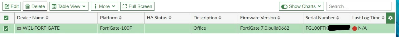

Serial is correct for the FAZ and the Device is configured (although it's still has it on it's old firmware version) I have removed and re-added the device already.
I am assuming there's a missing or incorrect SSL certificate here and it just needs to redownload from the FAZ however I can't find an obvious way of clearing the Settings and letting me add the device from the Fortigate side (as if it was never added before) or importing the correct certificate. I have already tried disabling the option for verification.
