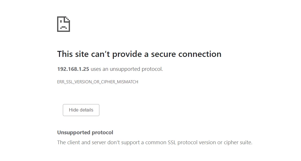

I have lab on EVE-NG setup SSL-VPN when access web mode from client then I can't access web

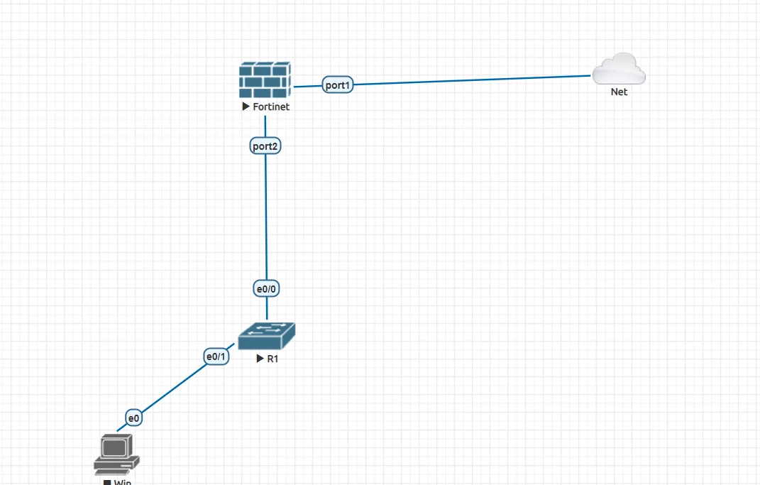

    This is topo

    Hi Truong,
    the error says it on screen: Cipher mismatch. The FortiGate and the Browser do not speak the same security protocol and fail to negotiate a TLS/SSL tunnel.
    Either your browser or FortiGate is ancient or your FortiGate is set up to not use strong-crypto or only allow older TLS versions.
    On CLI you can search for it:
    show | grep crypto -f
    show | grep TLS -f
    show | grep SSL -f
    Respective options might have to be changed. A good idea to do so. Above error message only appears when one of the clients isn't speaking up-to-par encryption standards for some reason.
