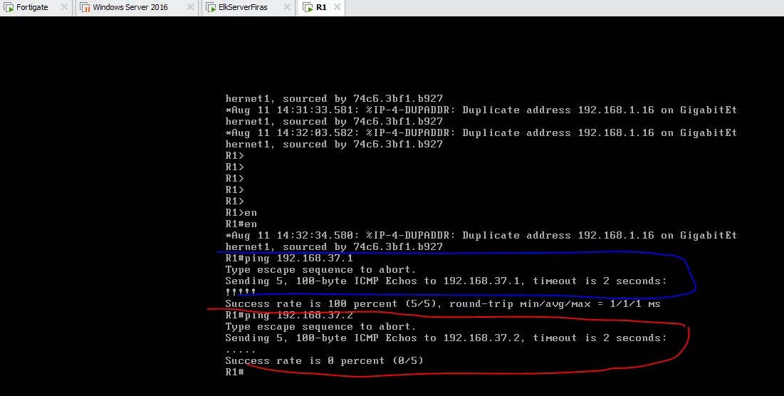

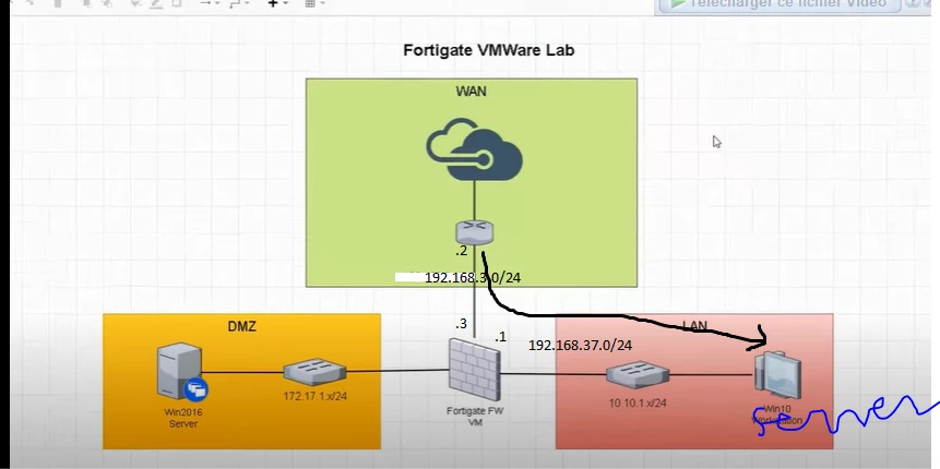

I can ping from the router to the interface of FortiGate that is connected to lan but I can't ping to the internal server and they are the two in the same network 294766800_562538495424875_9082956238751245529_n.png

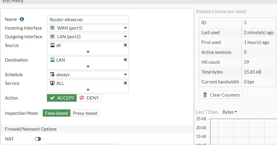

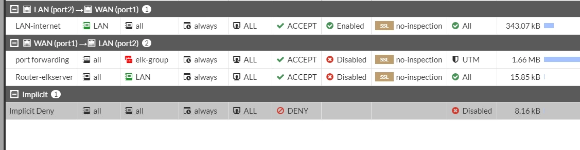

this my policys

Is firewall service disabled on the server?
Please run the debug flow on Fortigate as follows.
diagnose debug reset
diagnose debug flow filter addr <IP>  (can be source or dest IP)
diagnose debug flow filter proto 1
diagnose debug flow trace start 1000
diagnose debug enable
After performing the test, you can stop debugging;
diagnose debug disable
