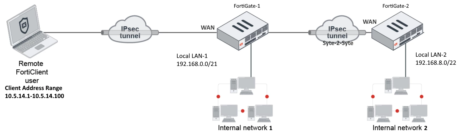

Can remote FortiClient user get access to local lan connected over syte-2-syte tunnel?
  • July 24, 2023
  • 4 replies
  • 2250 views
Hello.
See picture, please.
Users from LAN-1 access LAN-2 without any problem over syte-2-syte ipsec tunnel.
Also Users from LAN-2 access LAN-1 over syte-2-syte ipsec tunnel.
Question.
Can the remote FortiClient user access internal network 2?
If so, how?
Now access only to network 1.
Thanks.
P.S.
Fortigate1 is FortiGate-61E model.
Fortigate2 is FortiGate-61E model also.

Hello,
Yes, SSL VPN users will be able to access the resources across Site to Site tunnel. Please refer to the below article-
https://docs.fortinet.com/document/fortigate/7.2.5/administration-guide/45836

@kjohri wrote:
Hello,
But remote users use ipsec vpn to connect.
Or does it not matter?
nithincs
July 24, 2023
yes, you could achieve it. Make sure to add dailup tunnel subnet in phase2 selector of the site-site tunnel.
in FGT1 source :10.5.41.0/24 dest :192.168.8.0/24
in FGT2 source 192.168.8.0 dest :10.5.41.0/24
In FGT2, add a routeto 10.5.41.0 via tunnel interface.
Make sure to have the policies in place at both the firewall.
With this it should work
