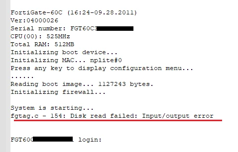

Model: Fortigate 60C (FGT60C)
When connect to console it has the following error message. The firewall can boot up and functioning.
Is there any way to replace this disk ?
And what disk is this ?
What is the function of fgtag.c ?
Thanks.

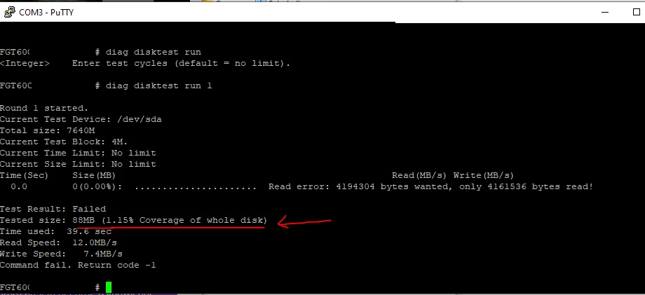

Hello,
I suspect hardware failure. I would recommend to perform HQIP test.

This disk is faulty as shown in following screenshot.
Can the disk be replace ?

Hello,
FortiGate 60C disk cannot be replaced. Firewall will malfunction, since configuration may not load properly on the boot.
