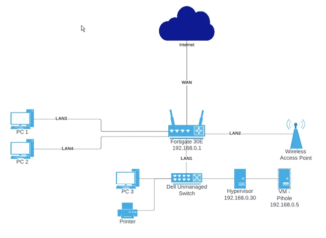

                      Thanks for reaching Fortinet Community. Would it be possible to attached the network diagram, so that we can better understand where the internal users and the server are connected to the FortiGate.
For now from the above description, I would assume you are wanting the FortiGate to forward all internal traffic (DNS traffic) heading to wan interface take a different route and reach your internal server that is on one of the other interfaces of the FortiGate. Ideally to achieve this we would need a policy right above the lan-wan policy that is actually being used now to route DNS traffic and the policy needs to have the interface on which the pihole server is connected as the destination.

Hi @Anonymous
Please see below.
Hope this helps explain. Currently I have LAN -> WAN policy that is blocking all traffic destined for the DNS service. This is stopping all devices on the network that do not use the DHCP provided dns server on 192.168.0.5 from being able to resolve.
This is desired and I simply want to further this and forward/redirect all that traffic to 192.168.0.5 so that it can resolve the requests and answer the hard coded devices. Reminder that the devices in question are chromecasts and Alexa devices which I am unable to hard code with my own dns server.
