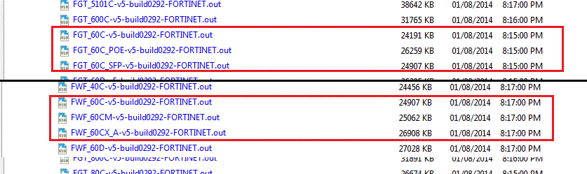

One of my client' s Fortigate 60C stop booting up properly after a power outage. I was able to connect the unit to a hyper terminal via the console port and it stated that the " Active Boot is corrupted" . I tried to format and reload a new BOIS image from TFTP Server. Everything seems to be moving along properly until I get the following message: ########################## Image Received. Checking BIOS image... Corrupted or wrong image. Please power cycle. System halted. I have tried different firmware versions for the 60C, including the HQIP and they all failed with the same message. I tried to scan the NAND for bad block, but the unit will not accept the " D" option at the console prompt (maybe it' s not supported on this unit). Is there anything else I can try? Any suggestion is greatly appreciated. Thanks,

    I may get this error if I mistakenly try to load a Fortigate model firmware into a FortiWifi model. Have you confirmed the firmware image was downloaded correctly from the Fortinet site via MD5 checksum? If the correct HQIP image fails to load into the fgt device, it may be time to open an RMA ticket. Perform a log capture of your putty or hyper terminal session (from start to finish) and include that in the ticket. The RMA department will also want your client to confirm their shipping/mailing address to send the replacement RMA unit to.

    Thanks for all the responses. I am certain that I have the correct firmware and HQIP images. I have also tried the following: - ran the md5 checksum to make sure the images are not corrupted. - two different TFTP Server I think the flash is gone and I will create a TAC ticket to start the RMA process. Thanks, Everyone.
