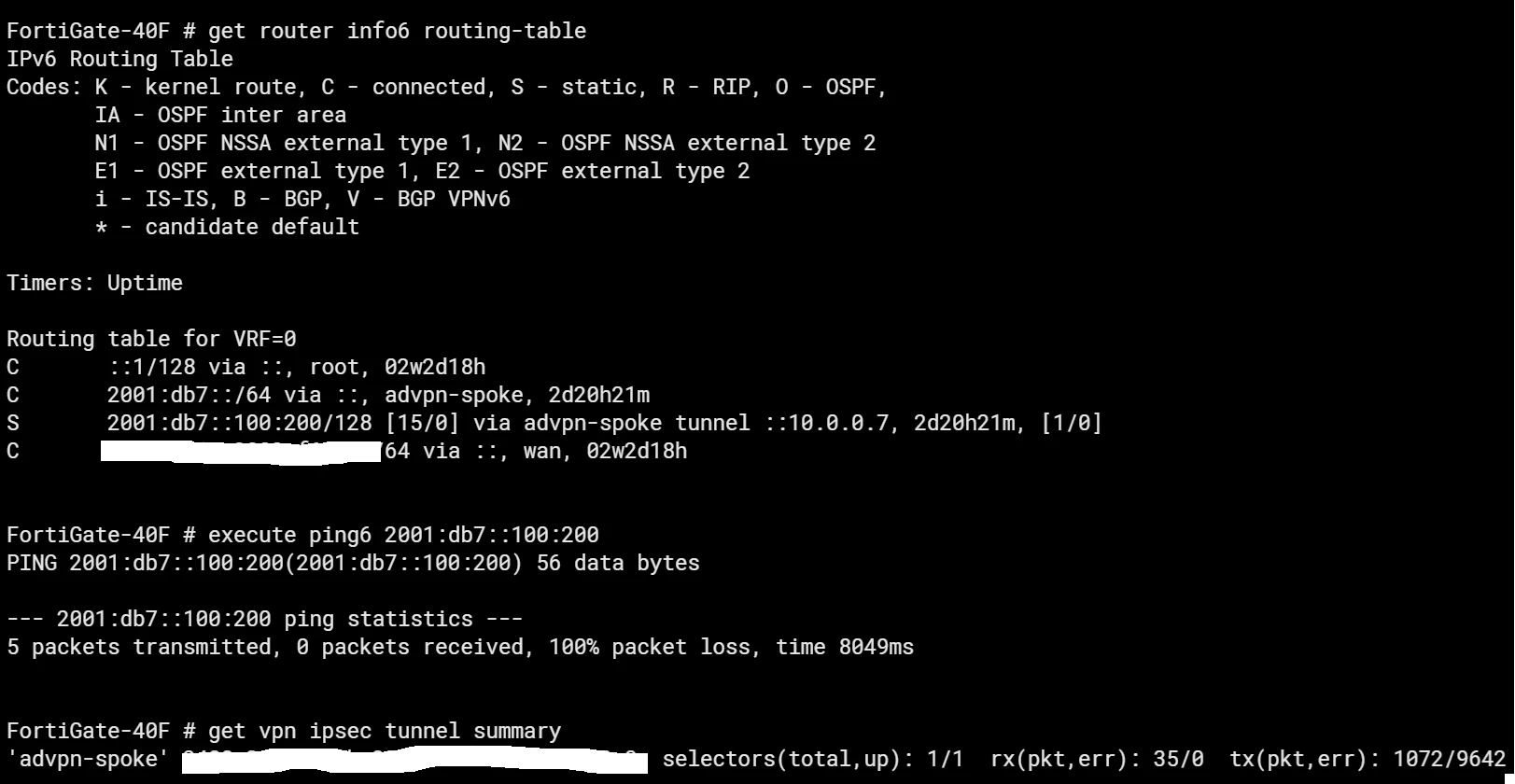

After performing a soft reset, there is still no bgp routes inserted into the routing table.
In fact , I even can't ping the hub router's vpn IPsec tunnel interface, even though it's in my IPv6 routing table.
  • The firewall policy allows all IPv4 and IPv6 traffic through the SD-WAN interface, which includes WAN, LAN, and the IPsec tunnel.
  • The ADVPN tunnel status shows as "up."
What could be causing this issue?
Here’s a screenshot from one of my spoke interfaces.
I can provide the configuration of the devices, so please let me know if needed.
My Background: I apologize for my limited experience. I’m currently conducting tests for the implementation of FortiSD-WAN in my company, building an SD-WAN environment with a hub (60F) and two spokes (40F). I appreciate any assistance you can provide.
