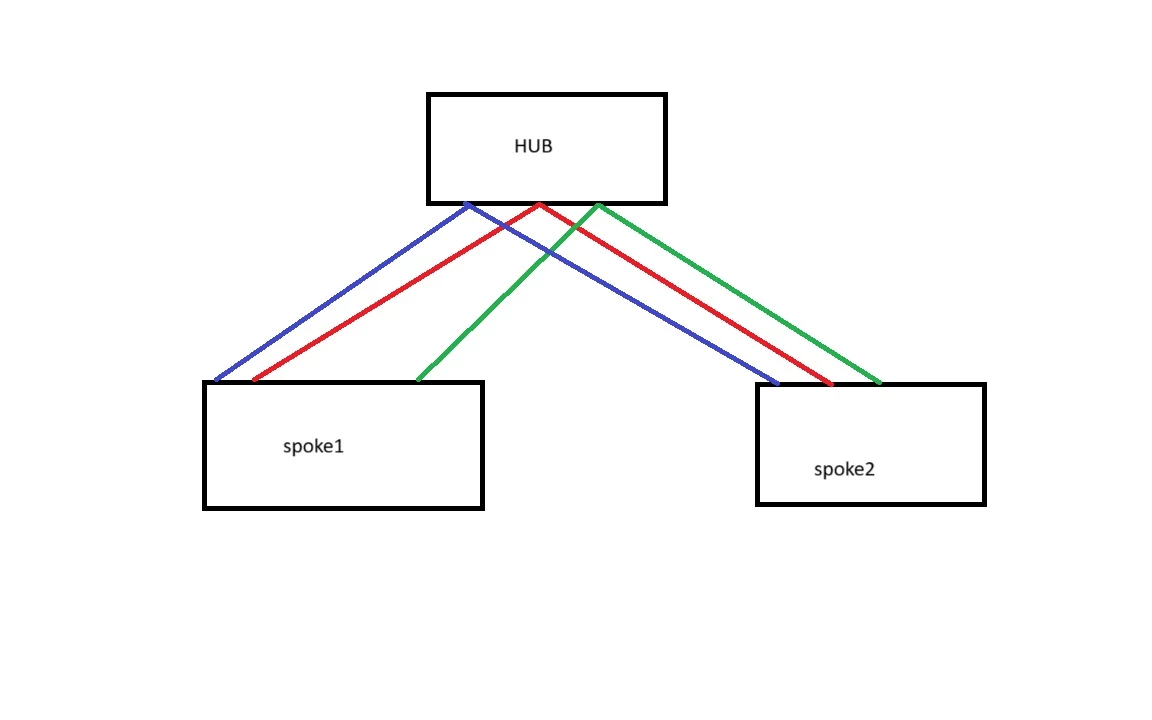

Hub & spoke have 3 connections (2 using internet and 1 using WAN) like below picture.
All 3 link configured as Route Reflector Client in the hub.

first thought is due to the fact that the hub is advertising them and using advpn, when the shortcuts are created you get them again from the spoke.
i assume that 10.103.113.1 is the hub tunnel ip, and 10.10.111.3 / 10.10.112.3 are the other spoke's tunnel ip.
