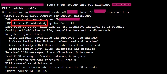

We’re currently testing BGP neighbor status changed alert, so everything is configured and after I trigger the alarm by deleting BGP neighbor from FMG by navigating to the HUB then (network>>BGP>>neighbors' range) then deleting one of the neighbors' subnets which refers to the spoke's devices range, the BGP tunnel doesn’t goes down and shows Established and the deleted subnet also appearing i the routing table on CLI.
the question is does my action was correct? and it’s a BUG in the system or there is something that I should do different?

What’s showing now under “config router bgp” in CLI? especially “config neighbor-range”.
You might need to delete the “edit <n>” section, not only removing the subnet.
And I wouldn’t trust GUI when I need to manipulate a status or a part of entire BGP config for test purposes.

there is something i need to mention that I deleted the neighbor subnet on FMG GUI and installed wizard but i can see the tunnel in Established state so hot it is deleted and Established at the same time?

once you did the install wizard and removed the neighbour config, did you see the config also being removed on the FGT?
Thanks, Salon
Ahmed_Abbas
May 20, 2026
yes, it is removed but i can see its still established

Can you share the details after deleting the BGP neighbor ?
show router bgp
get router info bgp summary
get router info bgp neighbors <neighbor ip>
get router info bgp network
get router info routing-table  details <neighbor IP>
dia sniffer packet any “host <neighbor ip>” 6 0 l
dia ip address list
