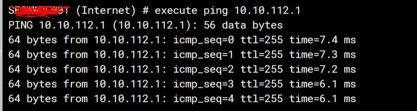

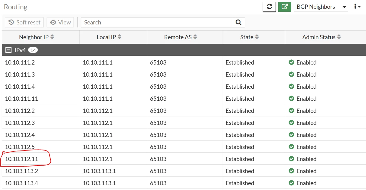

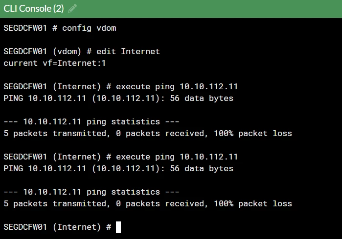

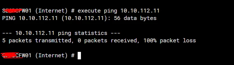

My fortigate hub have BGP connection to the spoke, the spoke ip is 10.10.112.11 and BGP was established.
But why i can't ping to that spoke bgp peer ip? So traffic from the hub can't reach the spoke using this tunnel interface
If i ping 10.10.112.1 from spoke to the hub the result is reply.

jdelafuente_FTNT
Apr 3, 2025 6:14 AM UTC

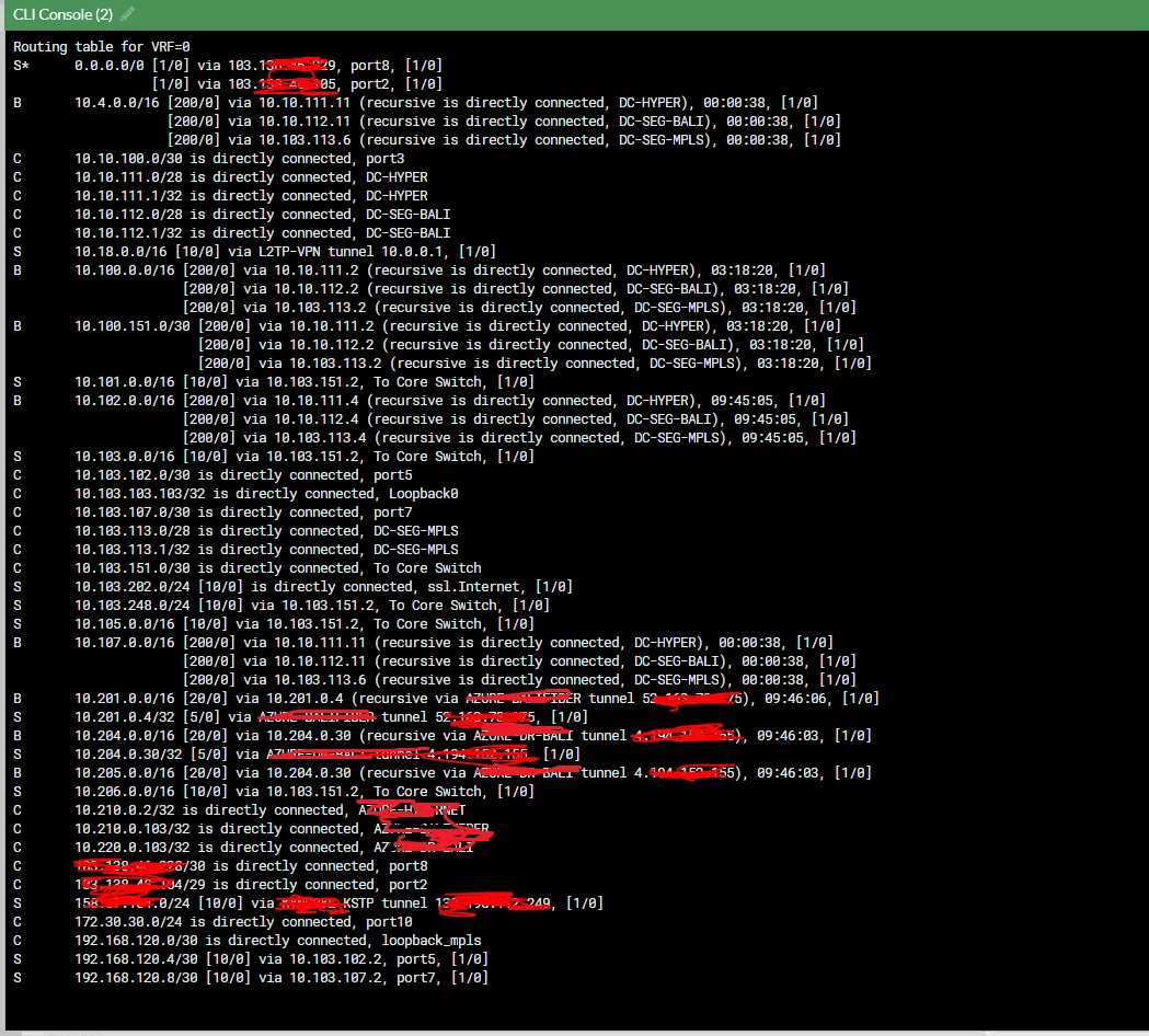

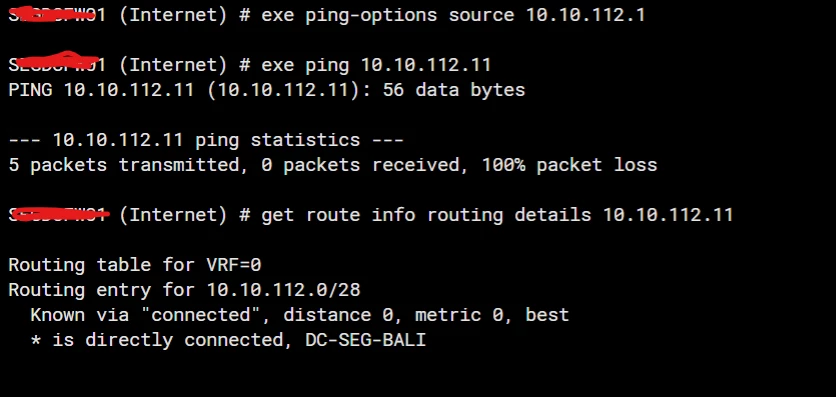

share output for:
exe ping-options source 10.10.112.1
exe ping 10.10.112.11
get route info routing details 10.10.112.11
get route info routing all
Translate
HS08
HS08Author
Valued Contributor
Apr 3, 2025 6:27 AM UTC
Here the result

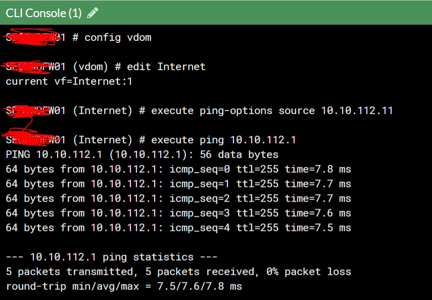

and here result if ping from the spoke
Translate

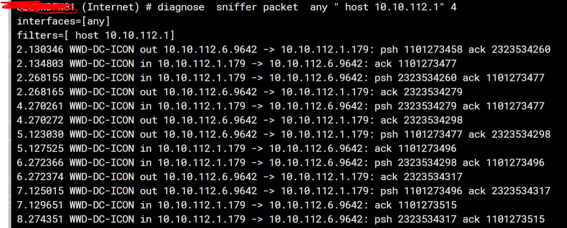

HS08
HS08Author
Valued Contributor
Apr 4, 2025 2:20 AM UTC
hi @dingjerry_FTNT , @funkylicious
There is no ICMP on the spoke, only psh and ack
Translate
Toshi_Esumi
Apr 4, 2025 6:20 AM UTC
What do you see if you have two CLI sessions, running this sniffing in one session and ping toward 10.10.112.1 in another? You said that direction worked.
Toshi

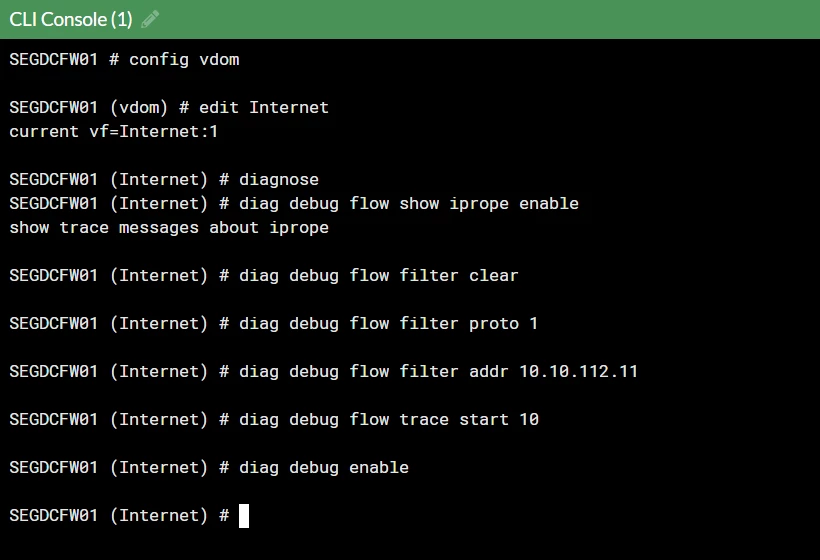

dingjerry_FTNT
Apr 4, 2025 3:50 AM UTC
Hi @HS08 ,
Please then run the debug flow commands on the Hub:
diag debug flow show iprope enable
diag debug flow filter clear
diag debug flow filter proto 1
diag debug flow filter addr 10.10.112.11
diag debug flow trace start 10
diag debug enable
Then initiate Ping, please do not run continuous Ping.
Translate
HS08
HS08Author
Valued Contributor
Apr 4, 2025 4:01 AM UTC
hi @dingjerry_FTNT
Here i enable the debug on the hub, then i open a new console and ping to 10.10.112.11 but there is no message log.

rmoussa
Explorer III
Apr 4, 2025 7:12 AM UTC
Hello,
From HUB you have to try to specofi the source address for the ping using exec ping-options source x.x.x.x
Regards
Rony
