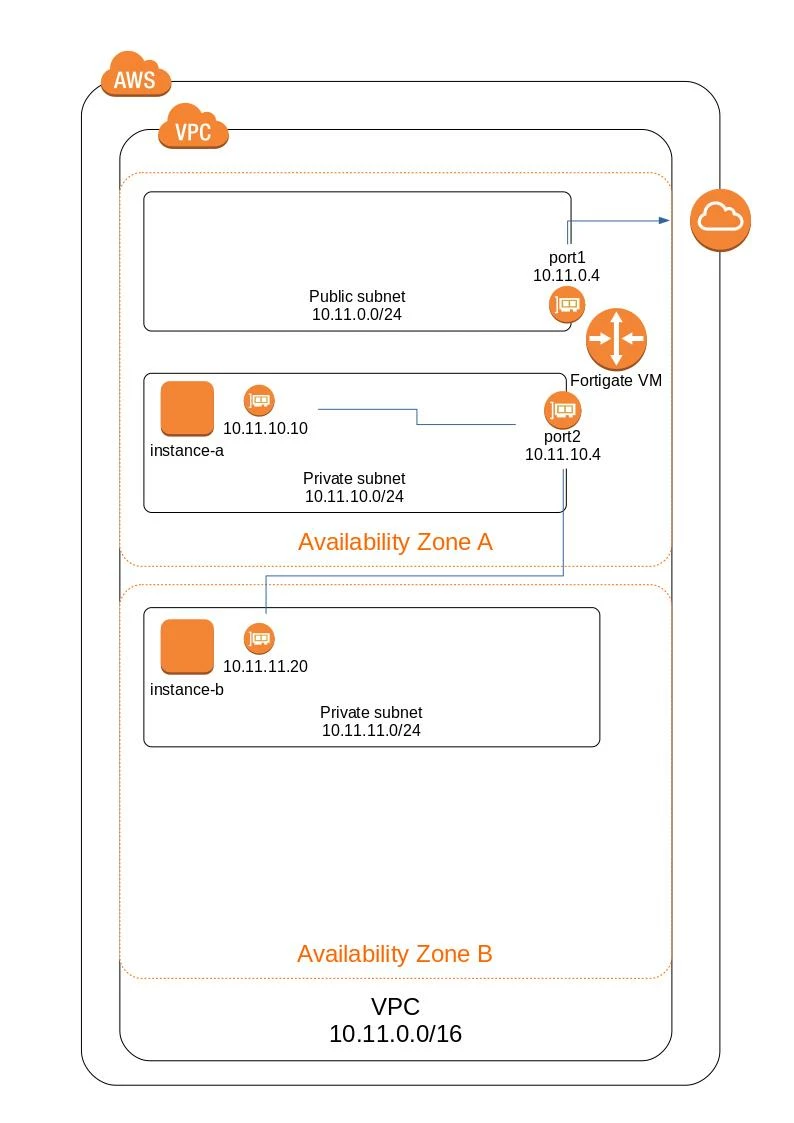

Hi folks,
This is my setup:
VPC with one (or two) public subnets and two private subnets, which are distributed between two AZ.
My fortigate vm has an interface in 10.11.0.0/24 (external) and 10.11.10.0/24 (internal). In Availability Zone A everything is working as expected. But when I try to get the private subnet 10.11.11.0/24 working with the fortigate vm, it doesn't work as expected.
Ping between instances in different AZs is working.
First attempt
Trying to ping from fortigate to 10.11.11.20 (instance-b) without setting a static route.

it goes through the external interface. But when i configure a static route (10.11.11.0/24) to the external interface, i have the same result as in second and third attempt.
Second attempt
Add Secondary IP Address 10.11.11.5/255.255.255.0 to internal interface

Third attempt
Added static route 10.11.11.0/24 to internal interface. Same result as Second attempt
Solution?
Does any of You have a tip or a solution for this problem?
Best regards
1 reply
les
lesAuthor
September 26, 2017
Hi folks,
FYI: the solution for this problem is to add a static route with the default gateway of the subnet:
config router static
        set dst 10.11.11.0 255.255.255.0
        set gateway 10.11.10.1
        set device "port2"
Which results in this routing table:
