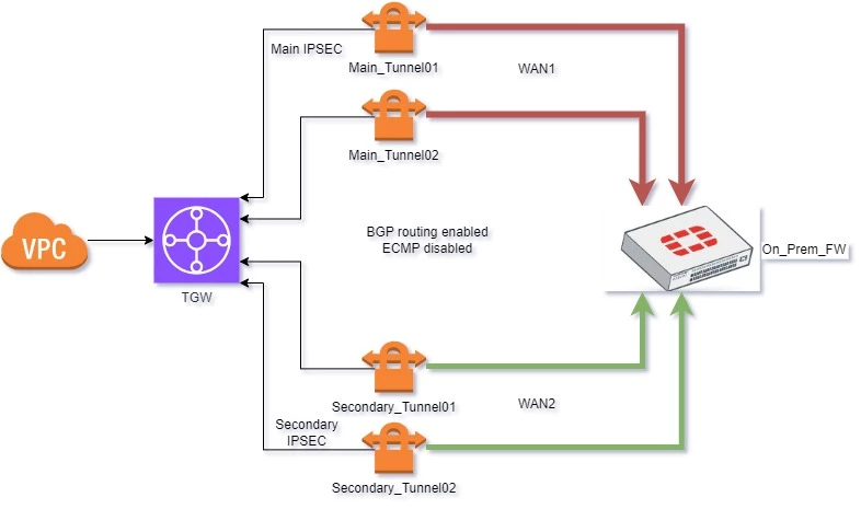

I´m having issues with the ECMP on the AWS TGW, what I need is just failover between the tunnels, but I want to setup the priority in which they are used under normal conditions, like in the following graph:
I want to influence the traffic (inbound and outbound) so it has the Tunnels in this order of preference:
  1. Main_Tunnel01
  2. Main_Tunnel02
  3. Secondary_Tunnel01
  4. Secondary_Tunnel02
Or
  1. Main IPSEC
  2. Secondary IPSEC
Right now, what I´m having (with ECMP disabled) is that I´m loosing traffic partially if I lose a Tunnel. If I enable ECMP, I get traffic through all the tunnels, and I do not want that.

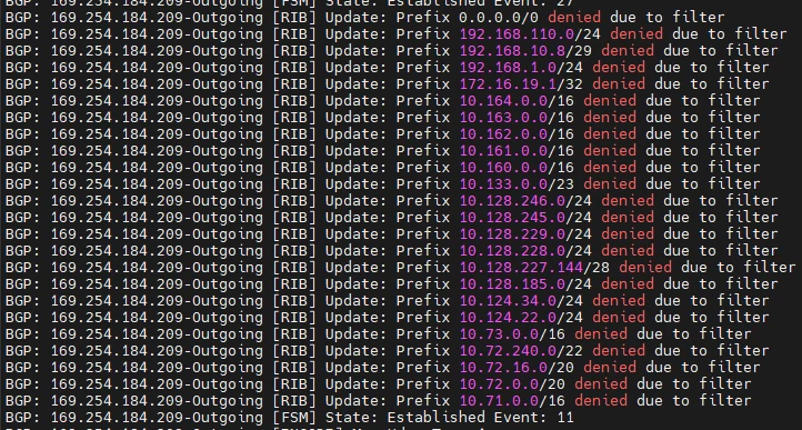

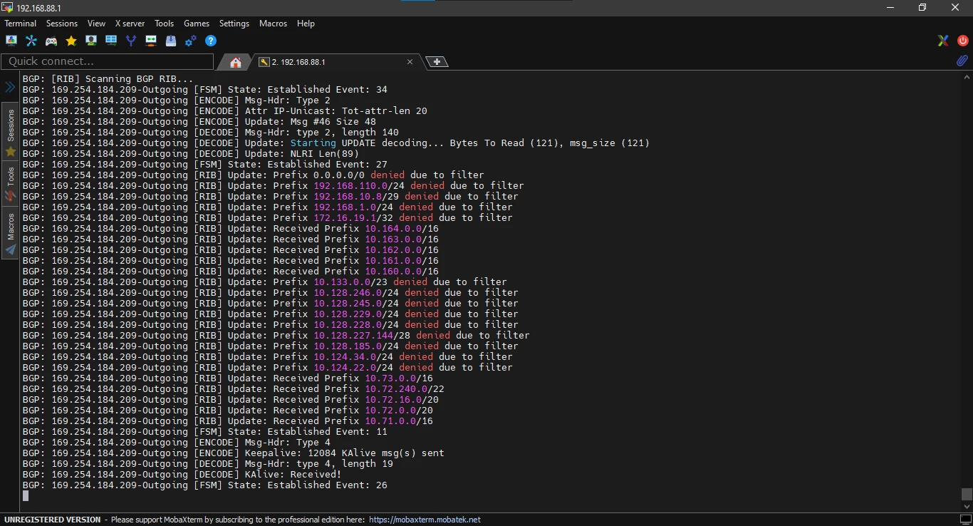

The AWS subnets. Let me get you a screenshot.
This happened when using the /11:
And then this happened when using the /15 and /25
What I really want is to receive just the /16 subnets. Because the other networks belong to other networks that I do not want.

Toshi_Esumi
February 8, 2024
I think 19 and 20 is prohibited if the network length is /20. Otherwise the error message the system gave me is wrong. Did you test and confirm as the fact?
Toshi
FortDoog
FortDoogAuthor
Explorer
February 9, 2024
That´s the thing, it did NOT give me an error. Now, there is one big thing I believe I did not point out, and it was critital to say: the firmware is 6.x.x. (I don´t recall the exact number right now). So most probably, the whole problem was due an old forgotten bug probably. and most most probably corrected in newer versions.
I know, you will ask why in 2024 we are running a 200F firewall on 6.x.x firmware... ask my management about that... I decided just to do my best with what I got / what I am allowed to do.
