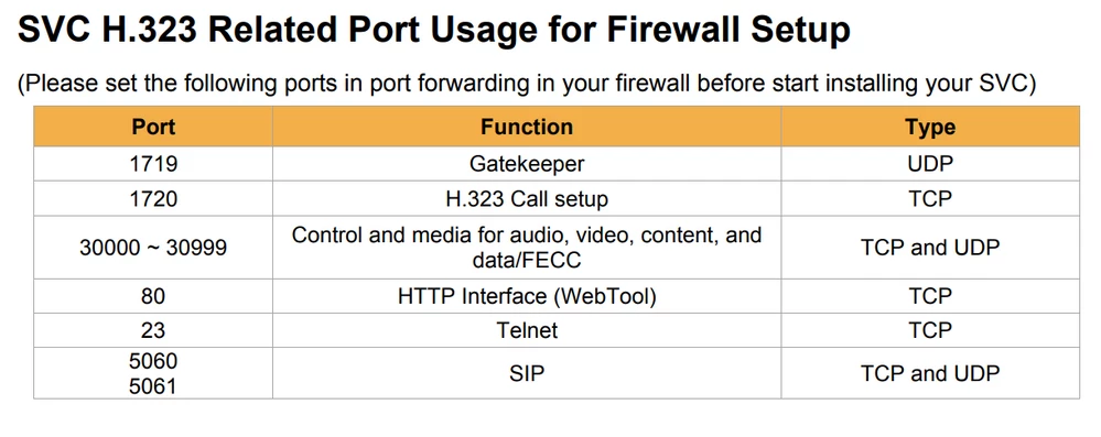

I want to install an video conference by AVER that supports H.323.
I have made the port forwarding the user manual states (see below photo) but it does not operate ok. i.e. although I can see and hear the remote party, my camera and microphone are not being transmitted remotely.
Can someone please help me?

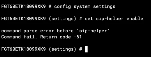

i go to cli and put the following commands but i get command fail error
config system settings
set sip-helper enable (or disable)
my firmware version is 6.4.8

AlexC-FTNT
April 13, 2022
You should familiarize yourself with the available commands in a FortiGate.
If you know a part of the command, you can do "show full | grep -f helper" and that will show you where the word "helper" is available.
In your case, you need to DISABLE H323 helper, and not enable it.
To disable it, you must delete it from the session-helper context:
https://community.fortinet.com/t5/FortiGate/Technical-Tip-How-to-disable-H323-and-RAS-session-helpers/ta-p/198262
