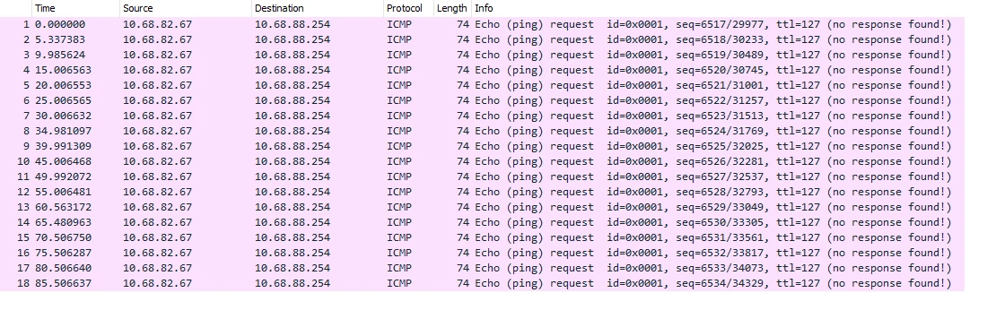

Hello everybody. I have a FortiGate 101E.
My interface 16 makes traffic to the VPN. On my 10.68.88.0 network everything works correctly. I have other networks but I can't get port 16 to accept requests. can I not ping. How do I authorize port 16 to authorize requests from other networks?
the routes are working well because I can communicate on the various networks. Port 16 is denying me requests from other networks on fortigate

Debbie_FTNT
June 13, 2023
Hey fearangel,
the ping request comes from IP 10.68.82.67, which is not in the same /24 subnet as 10.68.88.254.
Does FortiGate have a route to 10.68.82.0/24 subnet via that port16 interface? If not, the ping would be dropped due to reverse path check failure; the reply path is NOT the same as the original request, and FGT will drop any traffic where the reply does not go the same path as original request if asymmetric routing is disabled (and it is by default).

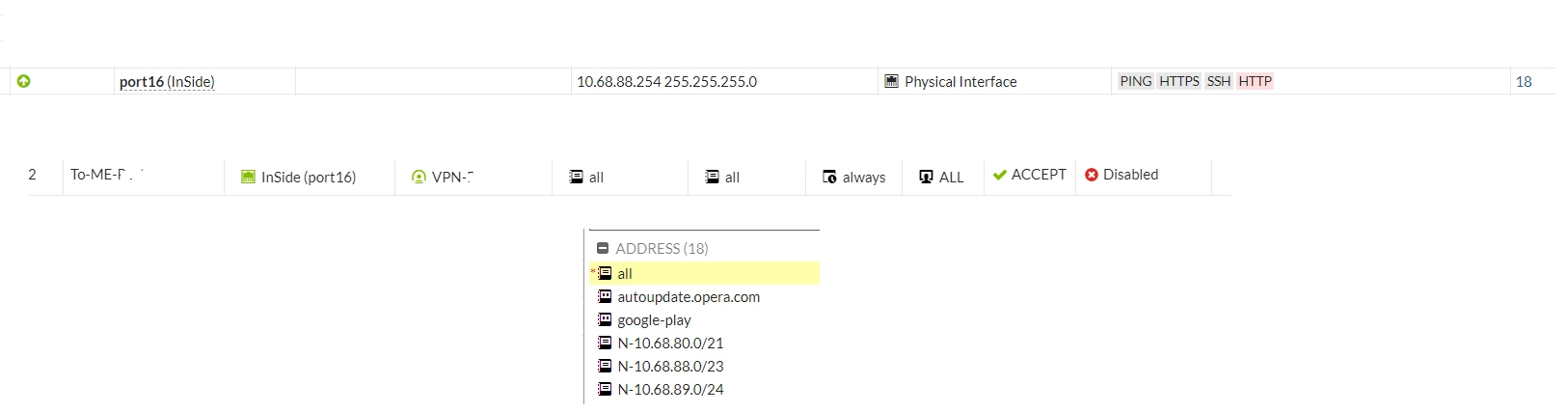

ede_pfau
June 14, 2023
IF the other networks are defined on other local ports of the same Fortigate, then there are routes in place automatically. If not, you need to set up static routes.
Apart from that, if you want to reach one network from one other, you need a policy to allow this. I guess there are no policies in place between the interfaces you mention.

mle2802
September 7, 2023
Hi there,
The source IP where the ping is out of range with interface IP. Can you please verify the routing by using the command "get router info routing-table details 10.68.82.67". If there is no route to this network via port 16, FGT will drop traffic due to RPF. Please refer to this document for more information "https://community.fortinet.com/t5/FortiGate/Technical-Note-Details-about-FortiOS-RPF-Reverse-Path-Forwarding/ta-p/190100"
