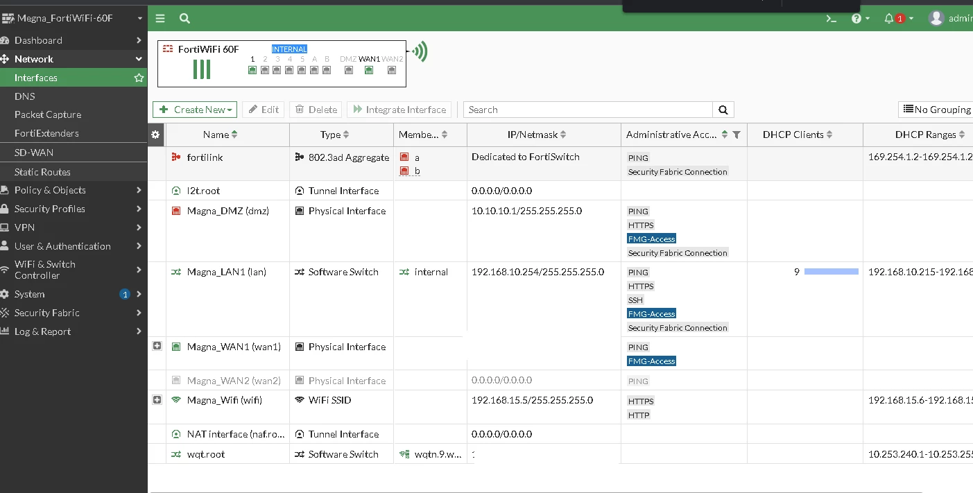

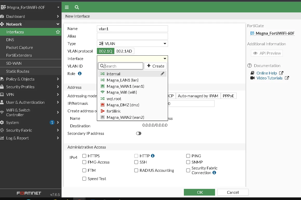

Dear All,
I have set firewall FortiGate 60F  V7.05
from
Technical Tip: How to create a VLAN tagged interface (802.1q) on a FortiGate - tagged/untagged traffic
in forum
There is Lan 1 only...
I want to separete differnet port 1 for vlan 1, port 2 for vlan2
but it show lan for total...
Please advise...
ThxLan1Lan1want to seprate vlanwant to seprate vlan

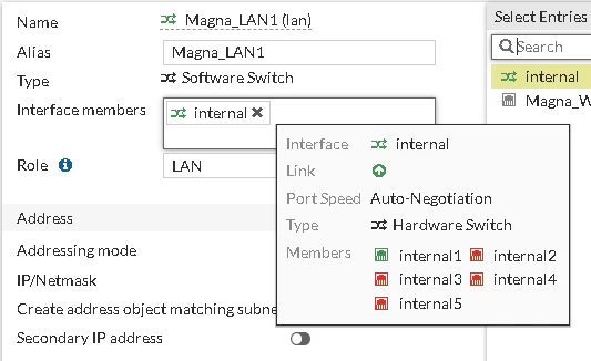

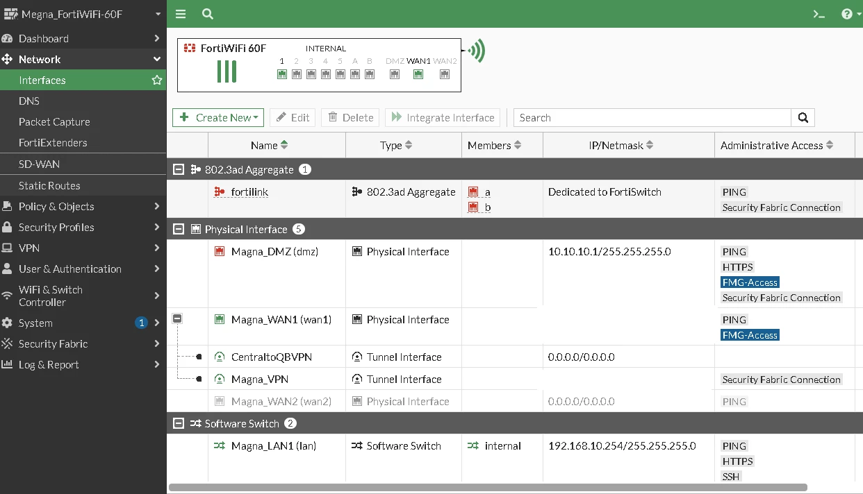

Best answer by pminarik
There is a cheeky way to remove one interface directly, without having to dismantle the soft-switch first:
  1. Open the "lan" switch interface.
  2. Notice the URL: /ng/interface/edit/lan
  3. Rewrite the URL to the name of the hw-switch and open the new URL: /ng/interface/edit/internal
  4. You should be in the GUI editor of the "internal" HW switch, and you should be able to remove the internal1/2/etc members as desired.
Apart from this, it should also still be possible to pop it out via CLI, if I remember correctly:
config system virtual switch     edit internal     config port         delete internal2     end end

akristof
July 13, 2022
Hello,
I think your internal port is vlan switch that has all other ports internal1-internal5 as a members. So you would need to remove internal2 port from that vlan switch and then you can create VLAN under that physical interface.

That is what I want to do....
I want to change  internal  port as you say,
I also find that internal contain menbers port 1 — port 5
Pls advise how to remove port2?
akristof
July 13, 2022
Hello,
Based on the screenshot you have software-switch that has the member your internal hardware-switch. You would need to remove this hardware switch from software-switch first and then you should be able to remove internal2 from hardware-switch. But in order to do this, you will need to remove current references for that Magna_Lan1 interface.
