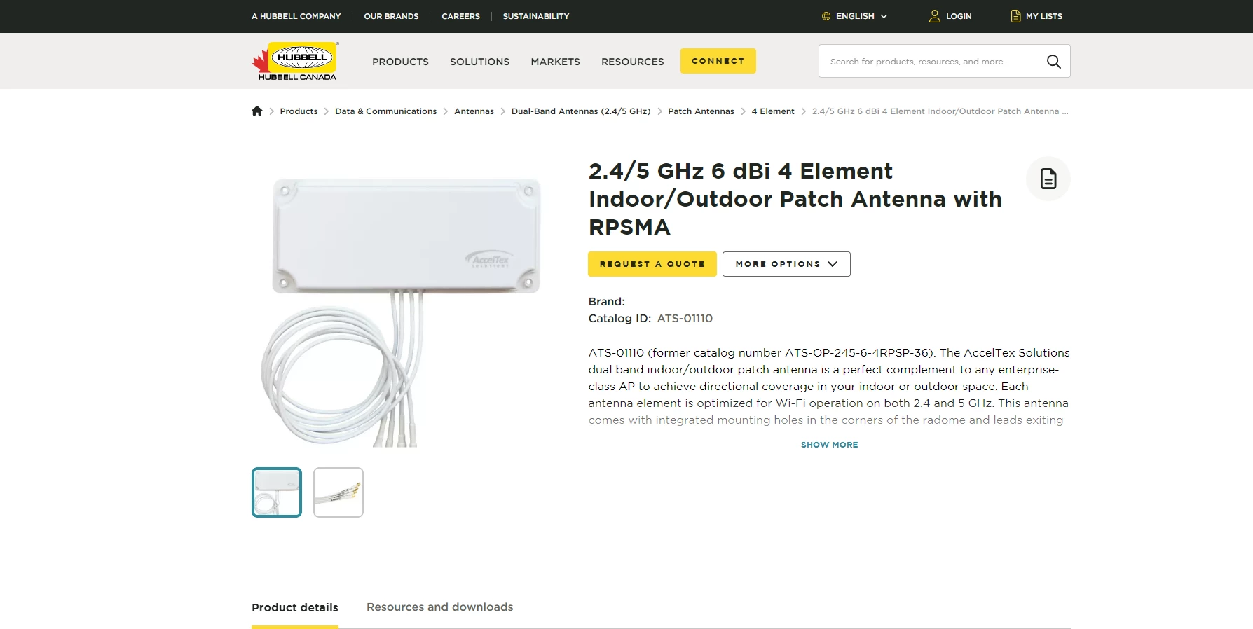

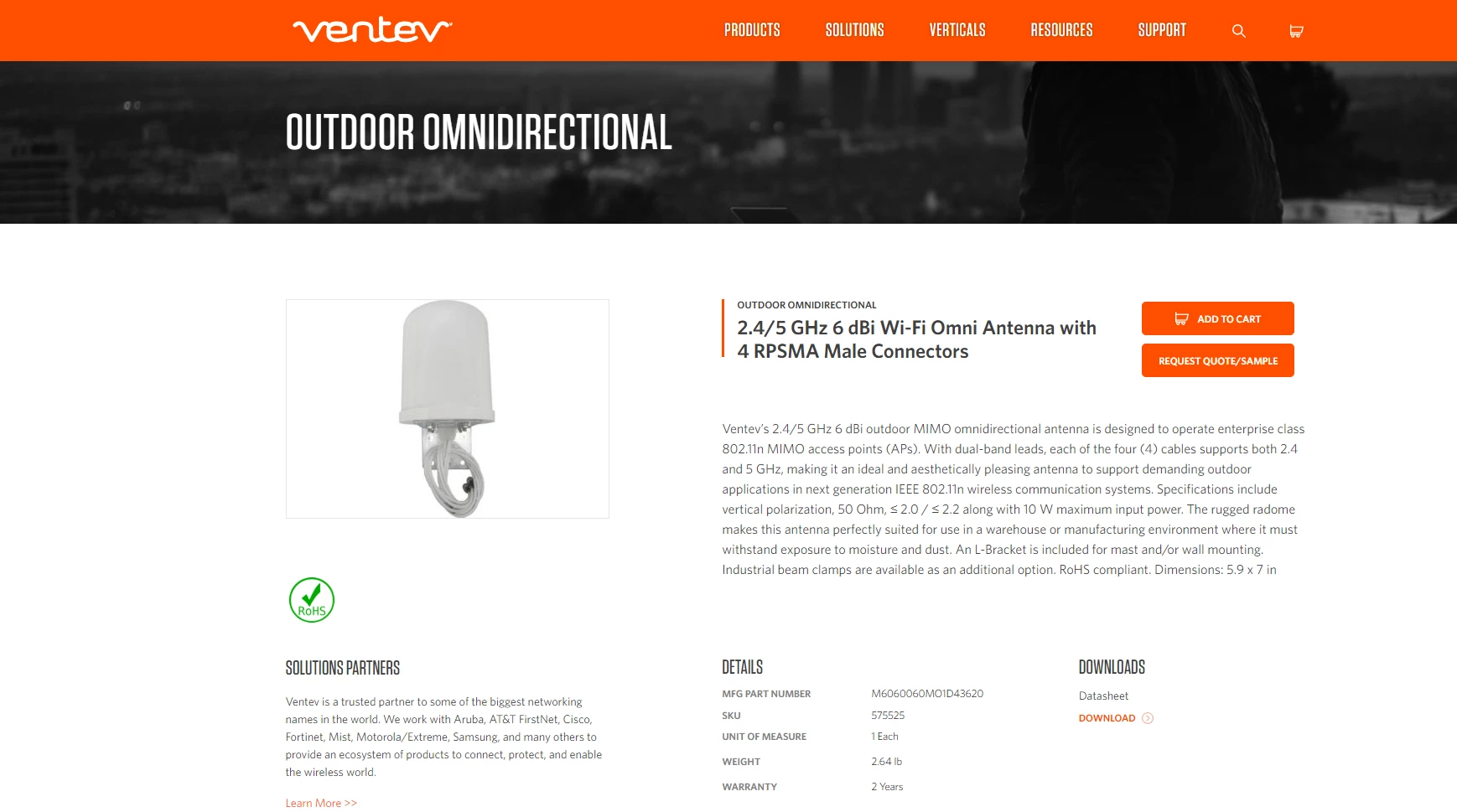

Hello,
I have a customer that wishes to deploy the FAP-433G access point in a facility which requires replacing the dipole 2.4/5 GHz antennas and using patch antenna similar to the FANT-04ABGN-0606-P-R and a omnidirectional antenna similar to FANT-04ABGN-0606-O-R.
When I search documentation on the 433G is states that the 433G supports third-party antennas.
My question is will a patch antenna from Hubbell/AccelTex  (AATS-01110 former catalog number ATS-OP-245-6-4RPSP-36) and theM6060060MO1D43620 omni-directional antenna work? ATS-01110 (former catalog number ATS-OP-245-6-4RPSP-36).pngM6060060MO1D43620.png

A simple way to find out is by comparing the physical specification of the antennas that can be found in the Datasheet. I guess this are the important parts:
  • Nominal Impedance 50 ohms
  • Max Power 100 Watts
  • VSWR ≤2.0
  • Connectors 4 x RPSMA Male
The coverage patterns need to be also checked. Fortinet doesn't have a compatibility matrix or test results done with 3rd party antennas.

If this is the case can I use the FANT-04ABGN-0606-P-R and the FANT-04ABGN-0606-O-R with FAP-433G or does it have to be a third party antenna?
ebilcari
October 21, 2024
Yes, using Fortinet Antennas is recommended. You can also discuss with your Fortinet local representative before placing the order but they appear compatible.
FAP 433G -> Antenna Type Support RP-SMA (4 total): Dual Band Antenna (4)
FANT-04ABGN-0606-P-R -> Connectors 4 x RPSMA Male
FANT-04ABGN-0606-O-R -> Connectors 4 x RPSMA Male or 4 x N-Type Male
Emirjon
