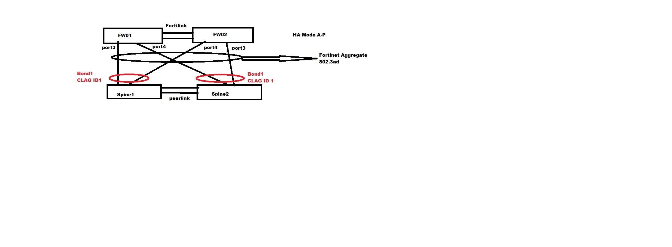

Hello Guys
I have this Fortinet configuration with HA active-passive mode, and an aggregate was configured with port3 and port4 on the fortinet side and in each Mellanox Switch that is in mlag mode (VPC in Cisco), an 802.3ad LACP with two ports was created (swp41,swp42) with a clag id.
The LACP on the Switch side always shows up, but on the fortinet side, it always shows us down the lacp in the Passive Firewall when I run a diag net aggr name Lacp_Spine the status is down, but the active one is always up.
I would like to ask you for help if this behavior is normal, where the passive always looks down.
