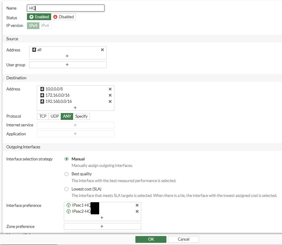

I have an SD-WAN deployment where a branch site establishes two IPsec tunnels to the head office.
The SD-WAN rule at the branch is configured so that traffic destined for the head office uses Tunnel 1 by default, and Tunnel 2 is only preferred if Tunnel 1 is unavailable.

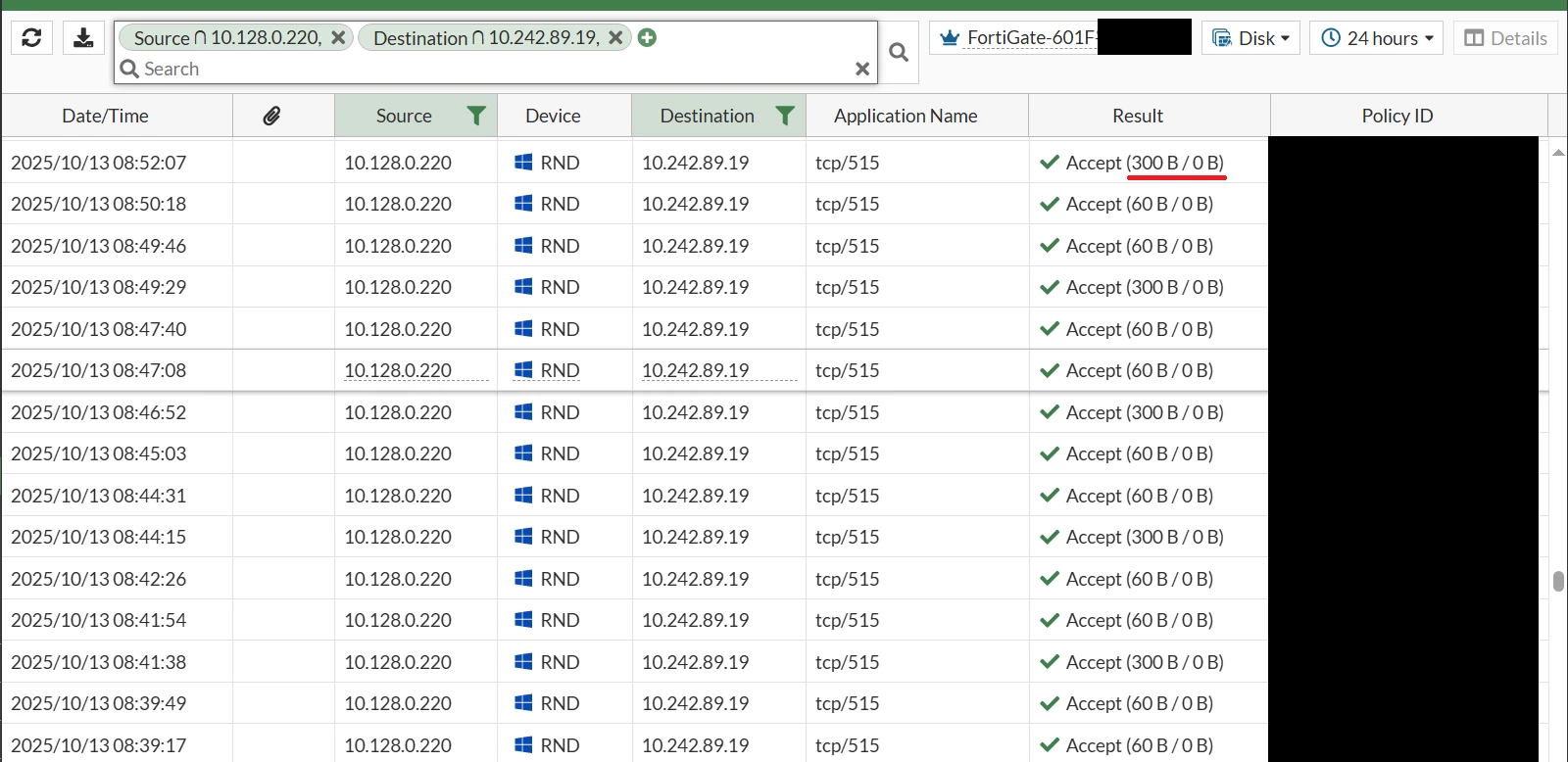

During a recent incident, we noticed that a printer management server at the head office attempted to communicate with a branch printer.
Screenshot Taken from Head Office FGScreenshot Taken from Head Office FG
(Printer MGMT server in Head Office - 10.128.0.220 & Printer in Branch - 10.242.89.19)
In this case, the head office firewall selected Tunnel 2 as the outbound path. The branch firewall, however, responded via Tunnel 1, which caused the session to fail.

The problem occurs when both IPSec1 and IPSec2 are up. We configured the branch firewall to prioritize IPSec1 using an SD-WAN manual rule, since it has the better underlying ISP. However, all sessions initiated from the head office to the branch are still being sent through IPSec2 from the hub (head office) firewall. Because of this, the session between the printer server and the printer does not get established. In the head office firewall logs, return bytes show as 0, and on the branch firewall there are no logs at all for this session. If I disable either IPSec tunnel at the branch, communication works as expected.
