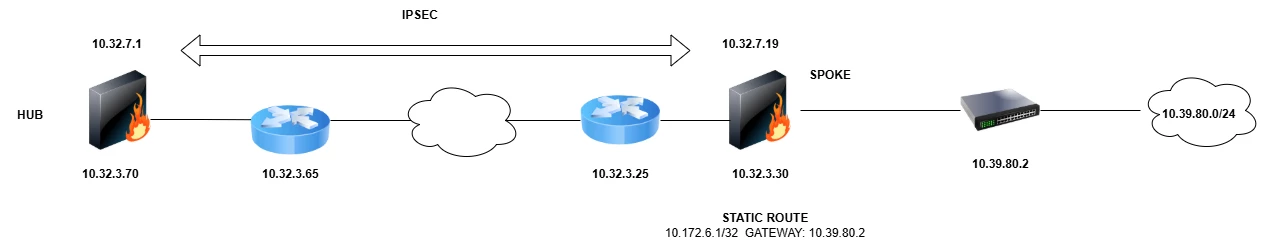

Hi, we set up an ADVPN Hub and Spoke network layout like this:
Hub is Fortigate 3000F, Spoke is Fortigate 60F.
We configured BGP on Hub and Spoke (on the IPSEC Tunnel)
We noticed that "connected networks" of spoke are distributed correctly:
10.39.80.0/24 -> IPSEC TUNNEL
but the static route (10.172.6.1/32 -> 10.39.80.2) is distributed with the wrong "next hop".
On the Hub we got:
instead we would
10.172.6.1/32 -> IPSEC TUNNEL
Any hints?
Best answer by pacionet
After some googling I found the solution: we set on the spoke:
set next-hop-self-rr enable
2 replies
pacionet
pacionetAuthorAnswer
December 4, 2025
