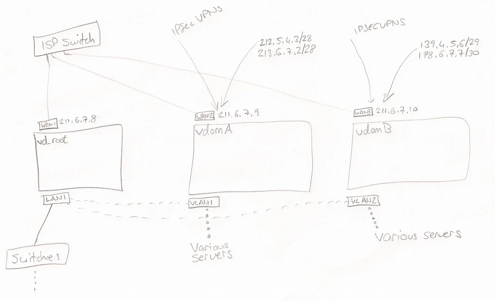

    July 25, 2013
    Hi Roman, I just thought I' d attach a basic logical diagram so you know what I' m talking about. So WAN1, WAN2 and WAN3 would be actual physical interfaces in each VDOM connected to the ISP and each would have a public IP like 211.6.7.8 etc., the ISP then route subnets of IPs to these IPs. There should be no big deal setting it up this way I think, but it means getting three ports from the ISP and as you say it seems like VLAN interfaces would be cleaner but it seems the ISP would need to be able to VLAN tag, then WAN2 and WAN3 could become VLAN interfaces right? Thanks!

    Hi, I don' t get the question right, I think. As I don' t know about your redundancy on the ISP switching side - Which seems one switch and would be some single point of failure. I' d bring the ISPs network into my switching infrastructure as a vlan and have everything there. redundantly... br, roman

    Thanks for the help Roman! It' s actually two switches on the ISP side, one per Fortigate, but as the Fortigates are running in a cluster I simplified that drawing above :). Anyway I contacted the ISP and it turns out they will not VLAN tag traffic to us, so I' ve just requested three ports per switch so we can give one to each of the three VDOMs which solves all my WAN questions! You mentioned above about using VLANs to allow VDOMs to communicate, can you explain how this is done in a bit more detail please as I' m a bit confused? This would be preferable as it would allow me avoid VDOM_links and hence use VDOM_partitioning! Thanks again for your help!
