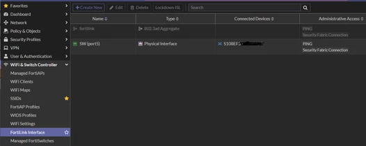

Hello!
This is my first time working with a Fortigate 100F router. I was trying to the the Fortilink to work. I was able to get the switches to show up and online however my access points would not. I played with it for a while and ended up changing the address mode on the Fortilink to lan and the Dedicated to FortiSwitch option is now missing. So I have two questions:
A) How do I set the setting back on the Fortilink so that the dedicated to FortiSwitch is the addressing scheme?
and
B) How can I get the access points to come online with the Fortilink connections between the switches and router?
Thank you in advance for the help!

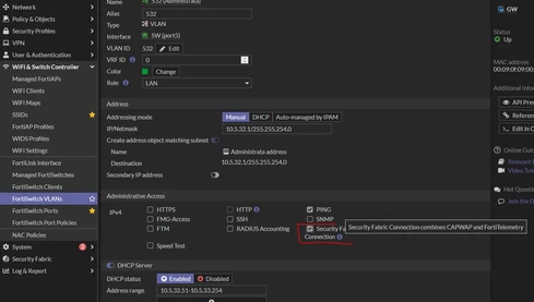

For the FortiAPs you just need to create a VLAN (subnet dedicated to AP management) enable DHCP and Security Fabric Connection. The APs will get IP and information via DHCP to reach and be auto discovered by FGT. The last step will be authorization.
