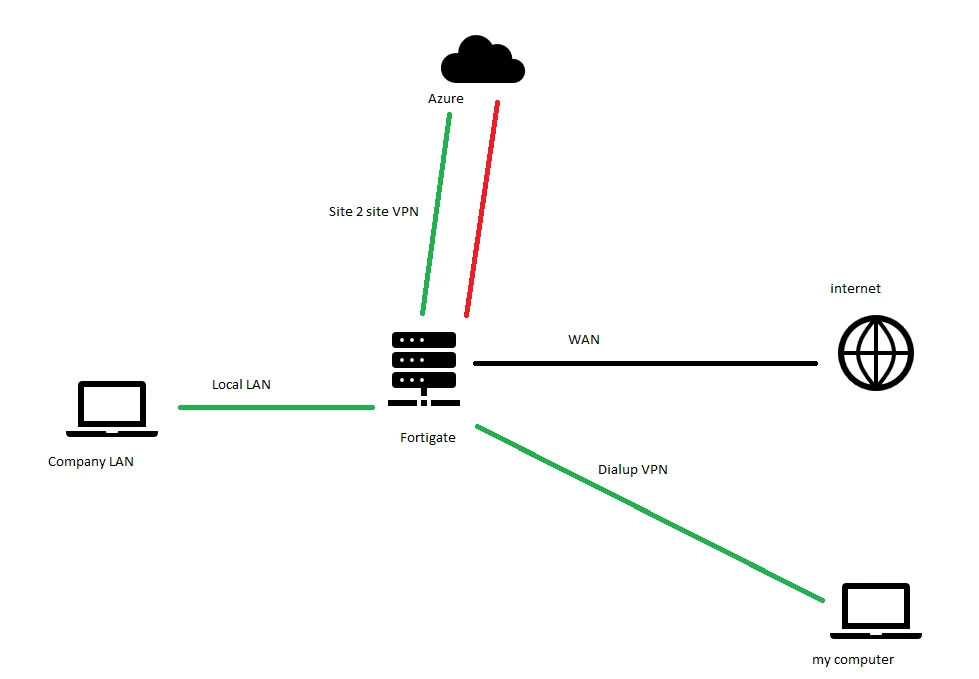

Hello,
I have a problem with port forwarding on Fortigate to an Azure webserver. The Azure network is connected via a site-2-site VPN and I would like to have it accessible from the internet. I think that the problem is with the VPN tunnel between Fortigate and Azure.
With the servers located on the local subnet I have no problems at all.
Here is how it all works:
Green lines are LAN\VPN connections - all work fine. Black line - connection through WAN - all good
Red line - packets forwarded from internet by forti to azure  - does not work
    1 reply
    Toshi_Esumi
    May 17, 2019
    Two possible problems I can see
    1. site-to-site VPN to Azure network is limited by phase2 selectors. Need to be 0/0<->0/0
    2. Azure side doesn't have a default route pointing into the site-to-site VPN to get back to the internet sources.
