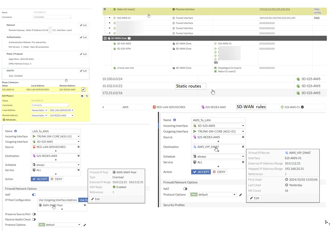

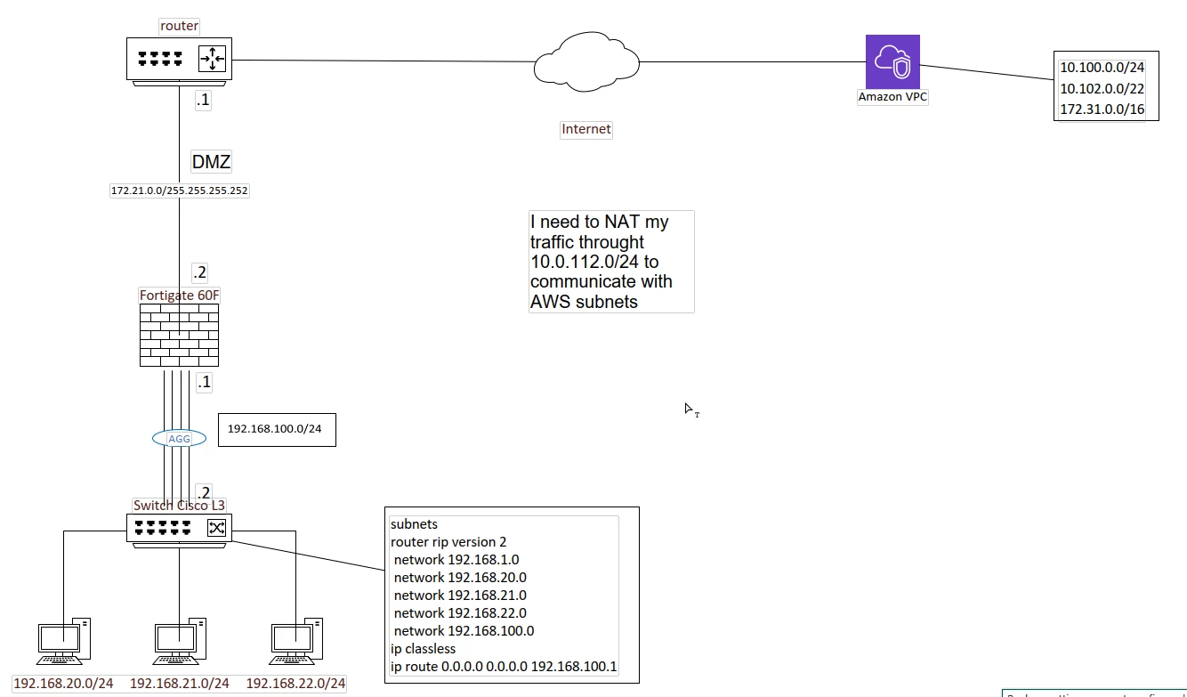

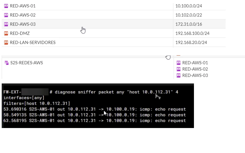

Where is the problem? tunnel up no ping

Hi robert44,
Thank you for reaching out. I believe the issue here is about phase2 selectors missing the ippool external ip as local address on the fortigate side and would be a remote on the AWS server. This is because you are natting the traffic on the outgoing firewall policy and I see the ping is stopping at the ipsec tunnel. You can further confirm this with running the following debug then start the ping again:
di de flow filter addr 10.100.0.19
di de flow filter proto 1
di de flow show function enable
di de flow trace start 10
di de console time en
di de en

robert44
robert44Author
Visitor III
October 9, 2024
You've saved my life, thank you. I owe you a beer. It works by putting an IP from the IP pool, specifically I've put 10.0.112.230/32  on phase2 and now I can ping :D
