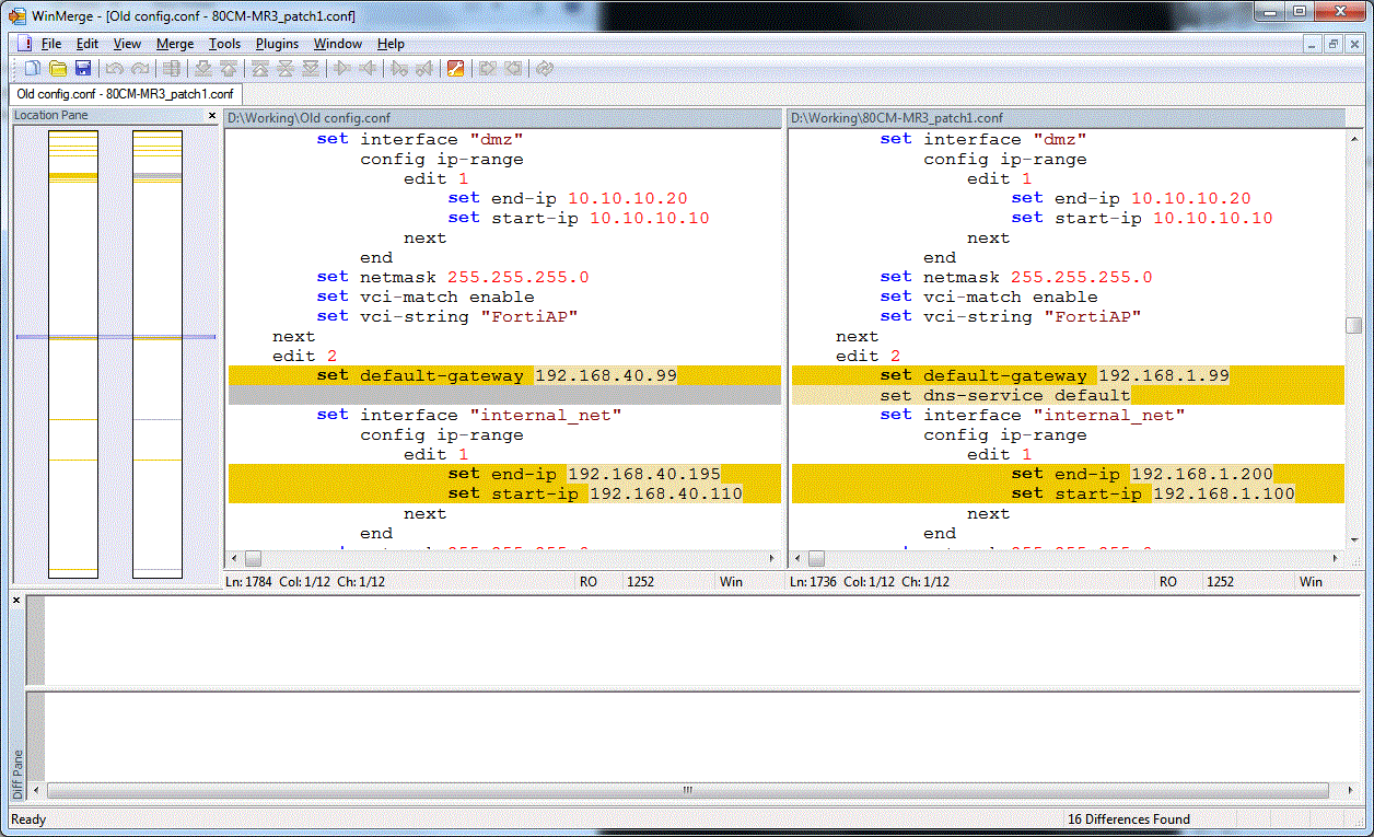

    Aside from the usually stuff you should be doing when performing firmware upgrades (follow upgrade path, read the patch notes, etc.) I will load the before/after config files into WinMerge (or other text comparison tool) just to see what exactly was changed during the upgrade.  Saves a lot of headaches.  I will also use WinMerge when I'm converting/migrating some key settings from one config to another one.
