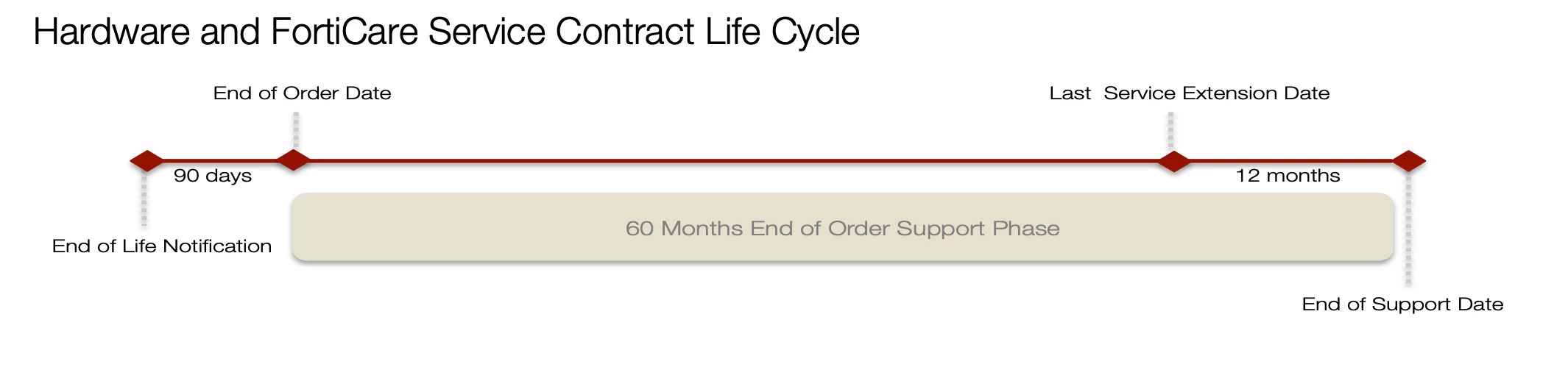

200F is a device that was released 3 years ago and the last order date has not been announced yet. Fortinet provides support for this device for another 60 months after this date is announced. For this reason, you can use the device you bought now for a minimum of 5 years.
You can see Fortinet hardware life cycle chart.
If you want you can get a price offer for 120G and you can compare it in terms of Price/Performance
