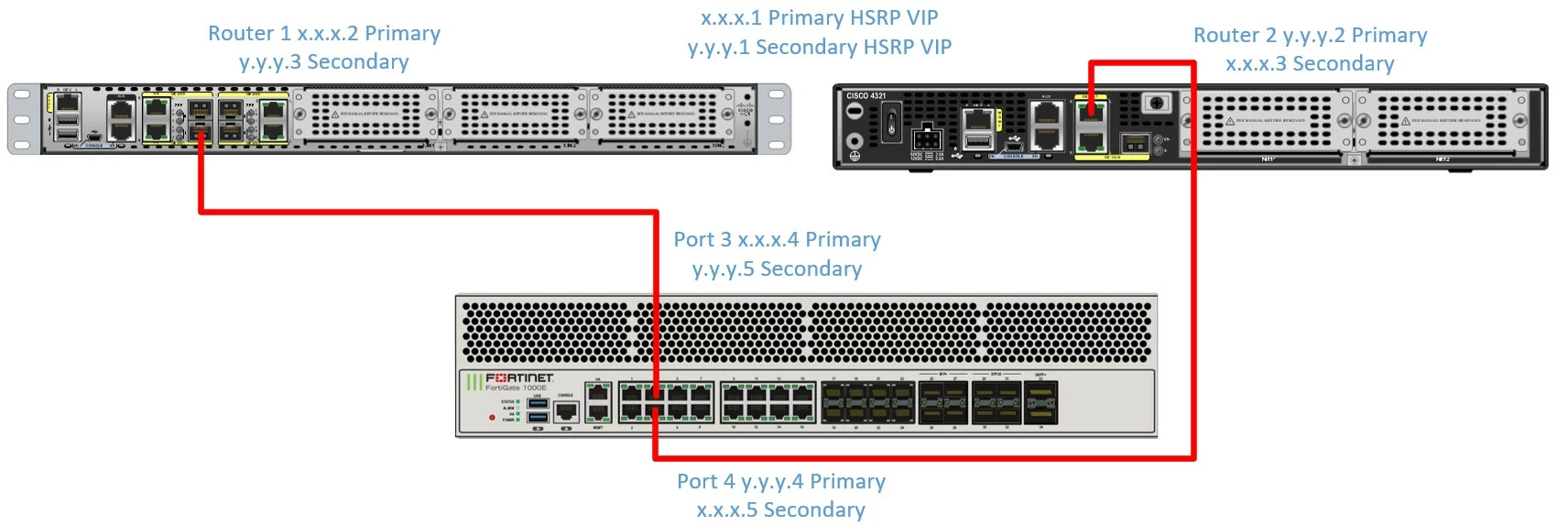

Hi All,
I have an HA pair of 1100E on 7.0.11 currently set up with SD-WAN
I have ordered a load balanced service from our ISP where I get two circuits, two routers and two /28 public subnets, and I am trying to set up my Fortigates before they go live.
I was told by my ISP that I could use them independently and choose which ones to route to using SD-WAN. To do this I was told I should use an IP address from router one's subnet for my WAN port on the Fortigate (Port 3), and to set up a secondary IP on Port 3 from the other subnet (Both subnets should be ok on one VLAN) I could then add this to the SD-WAN pool
I would then need to set up another WAN port (4) with an IP from router 2's subnet, with a secondary IP from router 1's subnet.
I can create the first port fine, but when I try to add the primary IP on the second port it won't let me as the IP is in the same subnet as the secondary IP on port 3.
Does anyone have other ideas as to how I should be setting this up? The two routers run HSRP so can take over the other's IP range if either goes down.

    DasToastbrot
    June 2, 2023
    This sounds odd to me. You won’t be able to configure the same subnet on two different ports on your FortiGate, no matter if its secondary on the one port and primary on the other.
    Also for HSRP to work properly on the routers you will need a switch to provide a L2 broadcast domain in between.
    If they agree to this I would probably rather have them hand over the 2 subnets on two different ports or vlans on each router. If they then have the HSRP prio higher on the first router for one of the vlan/ports and vice versa for the other router/vlan/port this would allow you to use both „lines“ active /active too and it would be way better to grasp.
    So if you go the physical port option
    Subnet 1 (HSRP pro on R1)
    P1 on R1 to Switch (VLAN X)
    P1 on R2 to Switch (VLAN X)
    FGT P1 to Switch (VLAN X)
    Subnet 2 (HSRP prio on R2)
    P1 on R1 to switch (VLAN Y)
    P1 on R2 to switch (VLAN Y)
    FGT P2 to switch (VLAN Y)
    This would work with just one port on each router and the FGT with tagged vlans.

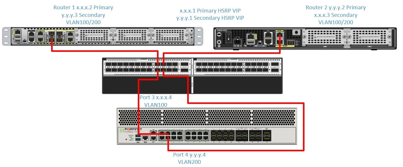

    andersh
    andershAuthor
    June 5, 2023
    Thanks for the reply, there is a switch in between but I omitted it for simplicity and probably shouldn't have. From the router point of view, that is what they are suggesting, using the two VLANs on a single port.
    But like you say, with two connections, one for each VLAN from the FGT I don't need an IP from each subnet for each WAN connection - not sure why they said I do!
    That makes sense to me so thank you very much for your help.
