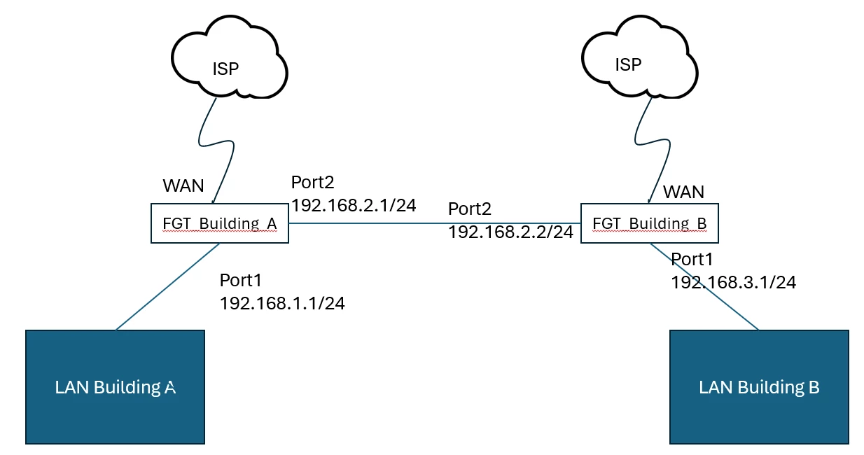

On my understanding, your connection is something like this.
Building B have primary ISP and you want all traffic to failover to FTT_Building_A when building B ISP went down.
The configuration should consist of:
FGT A:
1. Firewall policy from Port2 going to WAN. Treat FGT_A Port2 as another  LAN network.
FGT B:
** Follow configuration stated on below guide
https://docs.fortinet.com/document/fortigate/7.4.3/administration-guide/360563/dual-internet-connections
https://community.fortinet.com/t5/FortiGate/Technical-Tip-Detailed-Guide-on-dual-WAN-setup-for-targeted/ta-p/276308
1. Configure static default route going to WAN and Port2.Port2 will be set with higher priority.
*** Distance should be the same.
config router static
edit 0
set dst 0.0.0.0/0
set priority 1
set gateway <Gateway IP provided by ISP>
set device "WAN"
edit 0
set dst 0.0.0.0/0
set gateway 192.168.2.1
set priority 10
set device "port2"
Reference: https://community.fortinet.com/t5/FortiGate/Technical-Note-Routing-behavior-depending-on-distance-and/ta-p/198221
2. Configure Link-Monitor. You should monitor the WAN interface.
3. Configure firewall policy. One for traffic from Building B LAN to WAN . Another firewall policy from Building B LAN to Port2.
4. Enable "snat-route-change"
config system global
set snat-route-change enable
Reference : https://community.fortinet.com/t5/FortiGate/Troubleshooting-Tip-Routing-Changes-and-SNAT-snat-route-change/ta-p/193787
If failover is not successful even after this configuration, please follow the troubleshooting steps provided on above comment by hbac.
