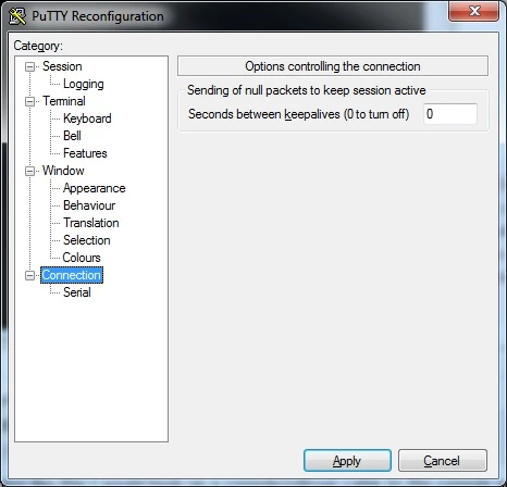

Something like this I would hook up a console/rollover cable to the console port and putty into it.  Keep the session open and log it over night or until the fgt crashes.  Never recall having to need to keep the session open, but putty does have a keepalive feature.

Thanks, I figured that would do it.  We are going to try turning traffic shaping off for now since the issues also started happening when we enabled that.  If that doesn't correct it the next step is a PC/putty setup to log the system crash.
