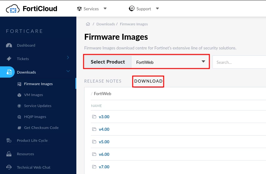

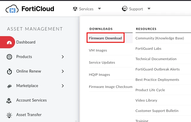

  • Log in to the Customer Service & Support web portal here, and select the 'Support' option then from the 'Downloads' section, select 'Firmware Download’.
  • Select 'FortiWeb' from the product selection dropdown list, then the 'Download' tab to get the available firmwares list:

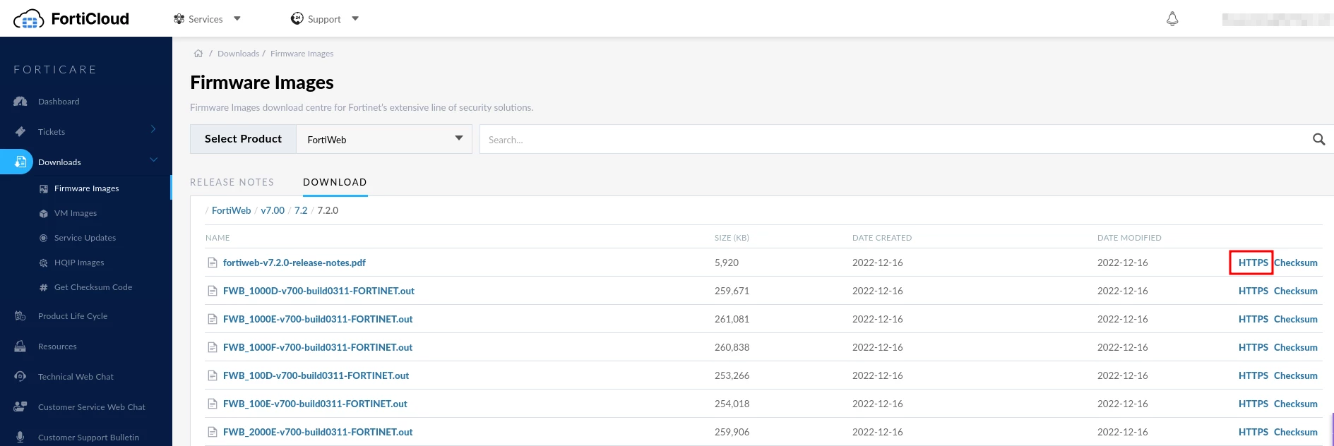

Select the required firmware version, and select  'HTTPS' to start downloading, then Save the image of firmware needed on the local disk.

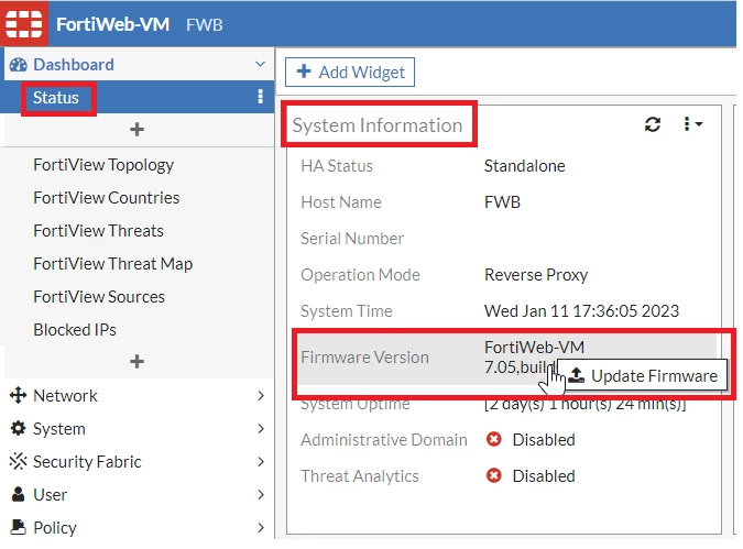

  • Browser to the below path. Go to: Dashboard-> Status-> System Information widget.

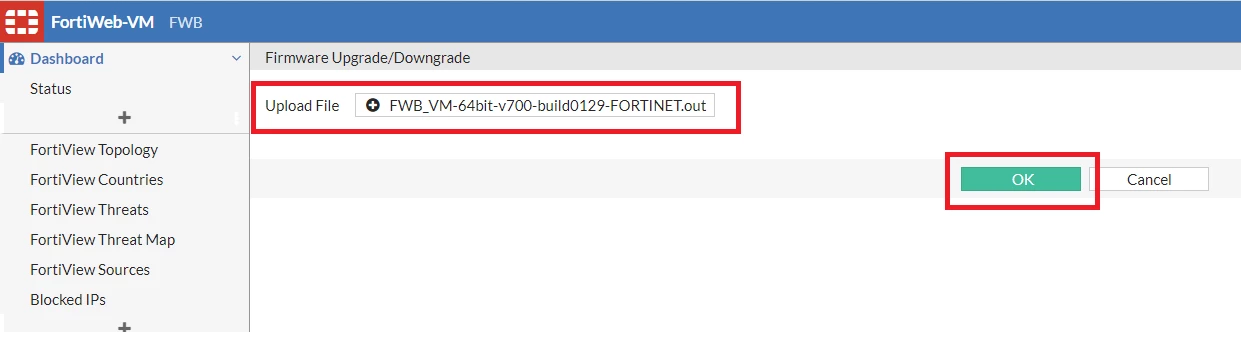

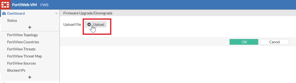

  • Select the 'Firmware Version', then select ‘Update Firmware' to start the upgrade procedure:
  • Wait for the uploading process to be completed and for the Fortiweb to restart.

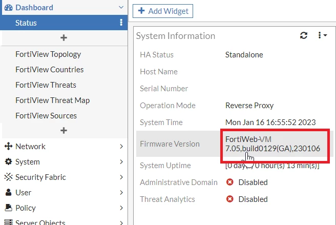

  • Verify the FortiWeb firmware version. Go to: Dashboard-> Status-> System Information widget.
