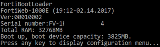

Upgrade firmware from the bootloader configuration menu.

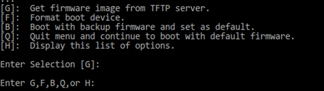

  1. Power on the unit, when this menu is displayed then press any key to go into the configuration menu.
  1. Press 'G' to select 'Get firmware image from TFTP Server'.

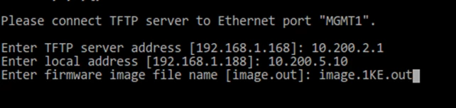

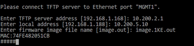

  2. Configure the TFTP server parameters.
Connect an RJ-45 cable to port 'MGMT1'.
TFTP Server
TFTP server IP address
Local address Local IP address
Firmware name Firmware name in TFTP server

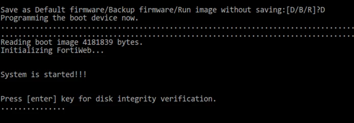

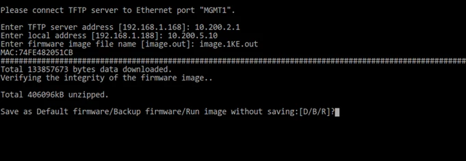

  1. Download and save the image.
Select 'D' to save as default firmware.
  1. Start system.
After saving the firmware, the FortiWeb is auto-started and goes to the login console.
