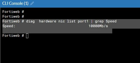

To check the Speed of the particular interface of the FortiWeb, the below command can be used. In this example, speed is checked for Port1.
Fortiweb # diag hardware nic list port1 | grep Speed
Speed: 10000Mb/s
Note: Make sure to use the spelling as it is mentioned above.
