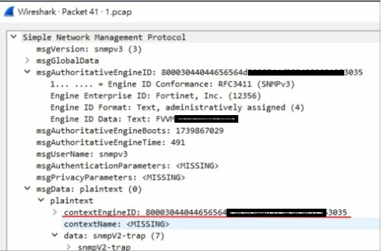

  • Engine OID is basically the combination of the prefix (8000304404) followed by the hex of the serial number of the device.
  • Engine OID can be found under snmpv3 trap packets.
