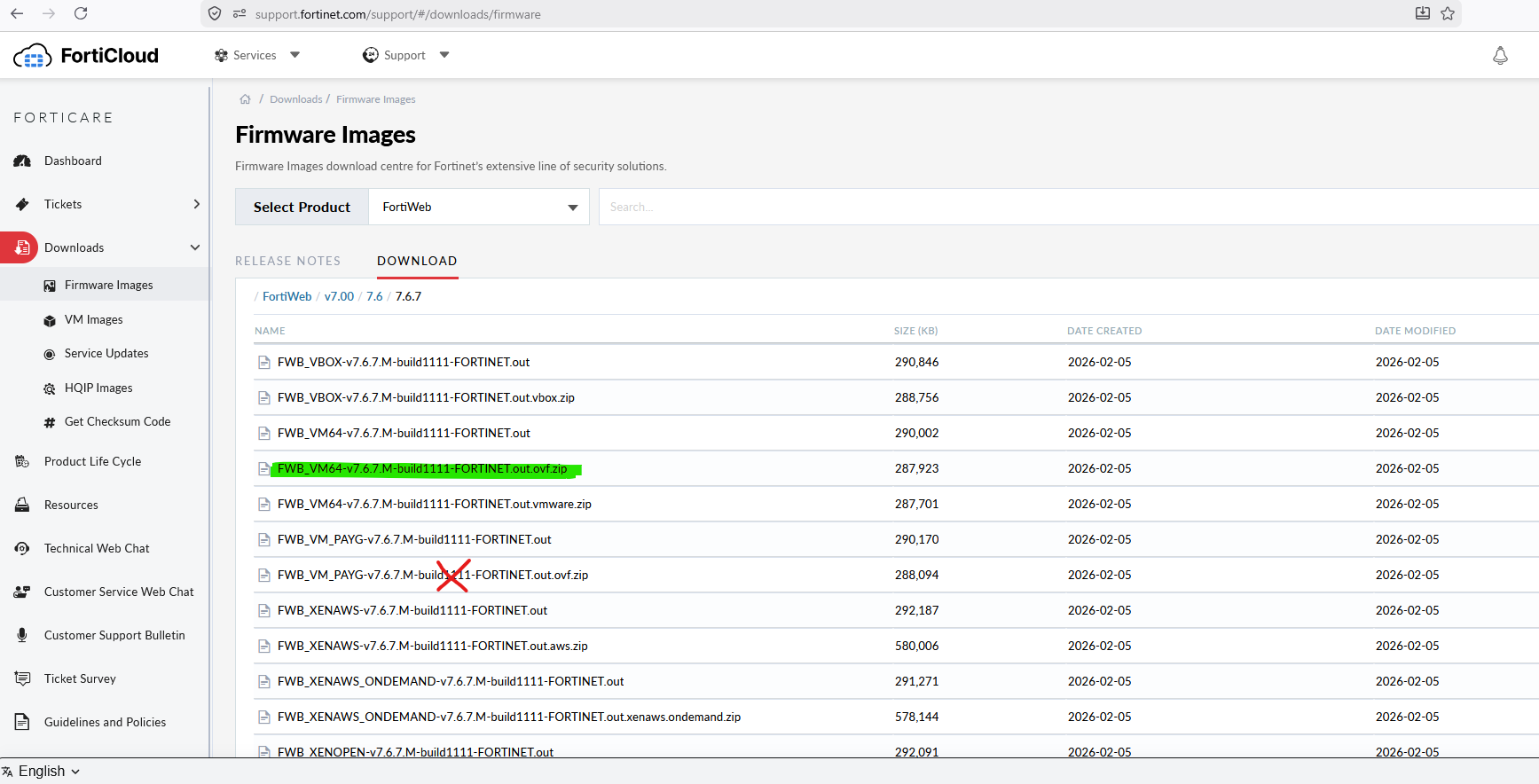

If the admin tries to verify that the proxyd process is running, no information is displayed.
 FWB# fn pidof proxyd
The issue is related to the wrong firmware FortiWeb-VM_PAYG was deployed. FortiWeb-VM_PAYG only works with FortiManager.
The right firmware FortiWeb-VM64 must be selected, and the VM needs to be redeployed.
