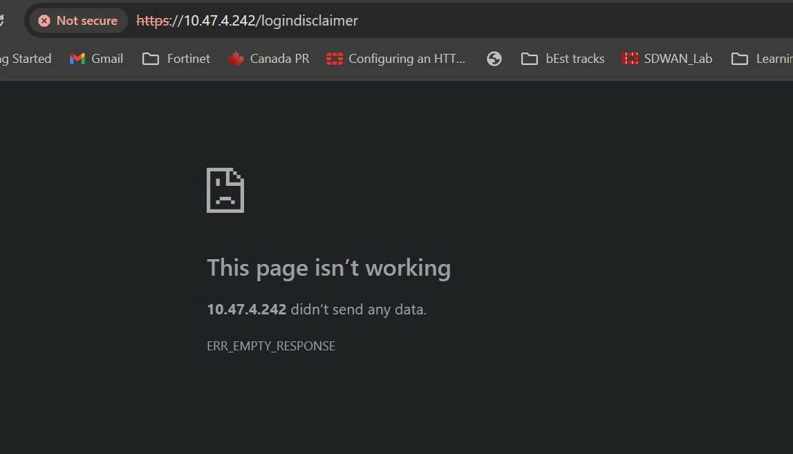

After upgrading the firmware on the FortiWeb, there might be an issue. The GUI is returning 'ERR_EMPTY_RESPONSE' for the Login banner, and the user will not be able to access the GUI anymore. However, the SSH will work fine.
This happens if the Pre-login banner is enabled. The error will look like the screenshot below:

This error only occurs if the Pre-login banner is enabled.
After issuing the above commands, open a new tab and enter the GUI by using FortiWeb IP. If there is still the same issue after this command, reach out to support for further help.
