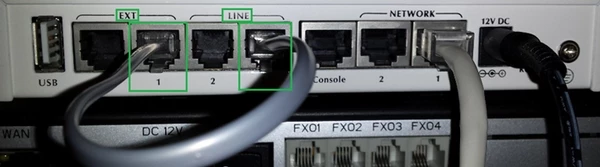

  1. Plug an RJ11 cable (analog phone cord) from port 'Ext1' to port 'Line1' to simulate a phone line as shown below.

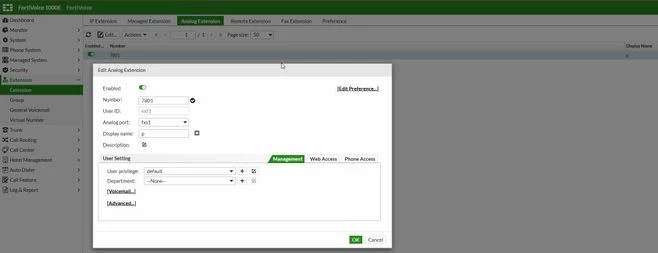

  1. Configure an analog extension.

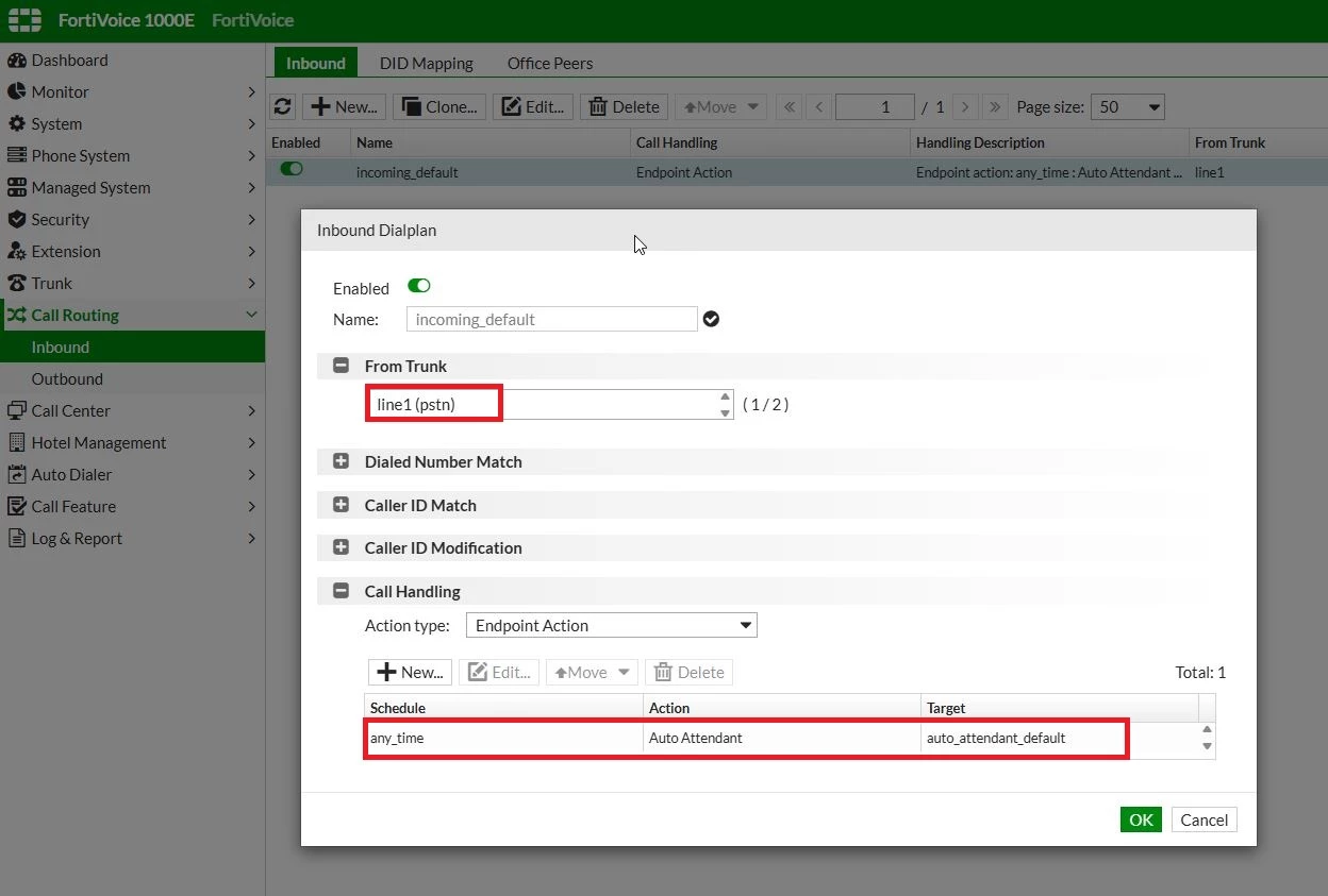

  1. The call will be handled on line 1.
  2. Create an inbound call handling pointing to an auto attendant.
