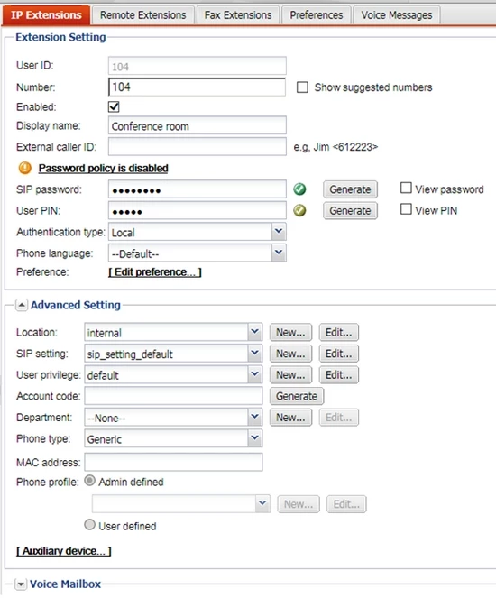

Start by creating an extension for the Polycom Phone as shown below:

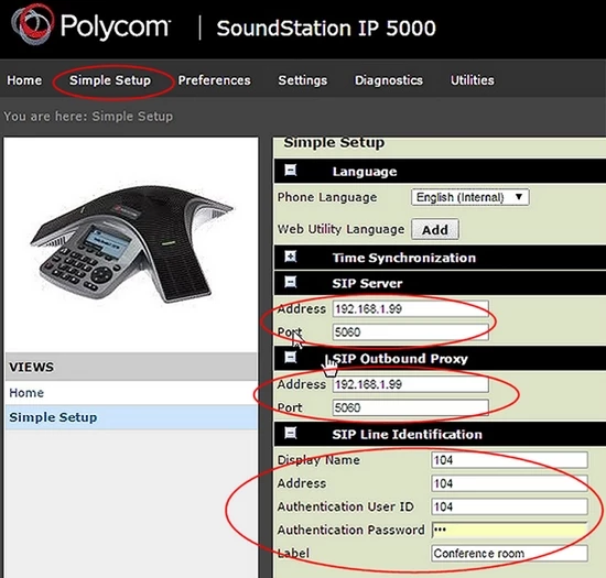

Select the ‘Simple Setup’ menu as below:
1) Expand the SIP Server menu and enter the IP address of the FortiVoice phone system followed by the SIP Port.
2) Expand the SIP Outbound Proxy menu and enter the IP address of the FortiVoice phone system followed by the SIP Port.
3) Expand the SIP Line Identification menu and enter the following:
Save the phone configuration and reboot the phone. The phone should register with the phone system.
Note that these steps are done with current Polycom firmware and will look like the screen capture of the interface provided above. If you have the red version please contact Polycom to see if a firmware update is available.
- Display Name: (extension number)
- Address: (extension number)
- Authentication User ID: (extension number)
- Authentication Password: (the password in the extension setup which can be viewed by checking the ‘View password’ box.
