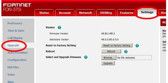

Go to Settings > Upgrade
Use the 'Browse' button to locate the firmware file that had been downloaded and extracted earlier. With the firmware update file selected it should show the version of the file. Select 'Upgrade' to begin the firmware update.

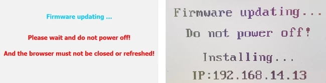

A firmware update process warning message will be displayed in the web browser, and a separate warning will appear on the screen of the phone itself.
When completed the warning should be changed on the phone screen (default screen) and the web browser will return to the Login page. The firmware update should now be complete.
